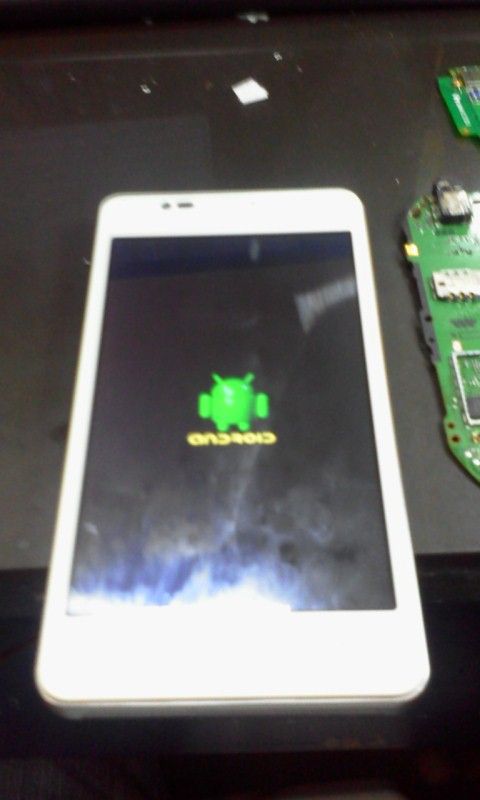

model: titan cherry mobile
problem: no lights, umiinit
history: picture2x ng classmates

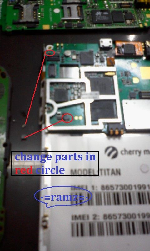

action taken: open ang unit, kapa2x mode umiinit ang coil,
remove and replace, shorted parin, replace diode ganun parin,
repalce 6 legs transistor same problem
last move try ko remove capacitor malapit sa lcd connector at nawala short nya,

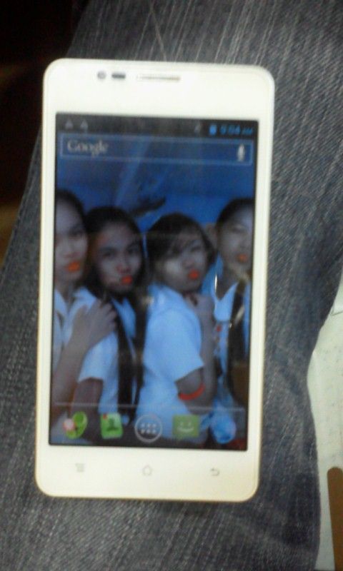

Testing..... viola maliwanag pera na
