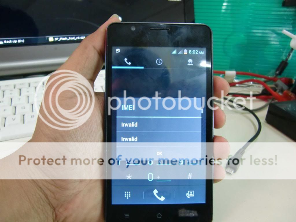

good day to all share ko lang po Cherry Mobile titan tv invalid imei.
history nag hang daw po unit pinareprogram sa kabila nabalik sakanya invalid imei na...

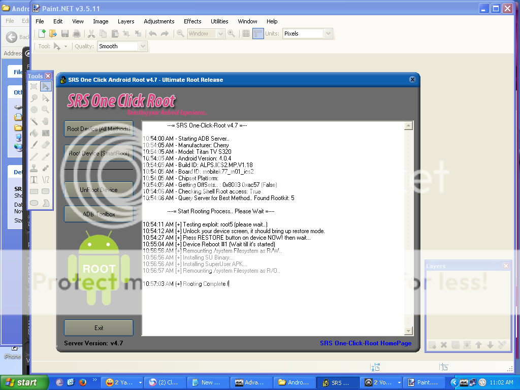

SRS one click root

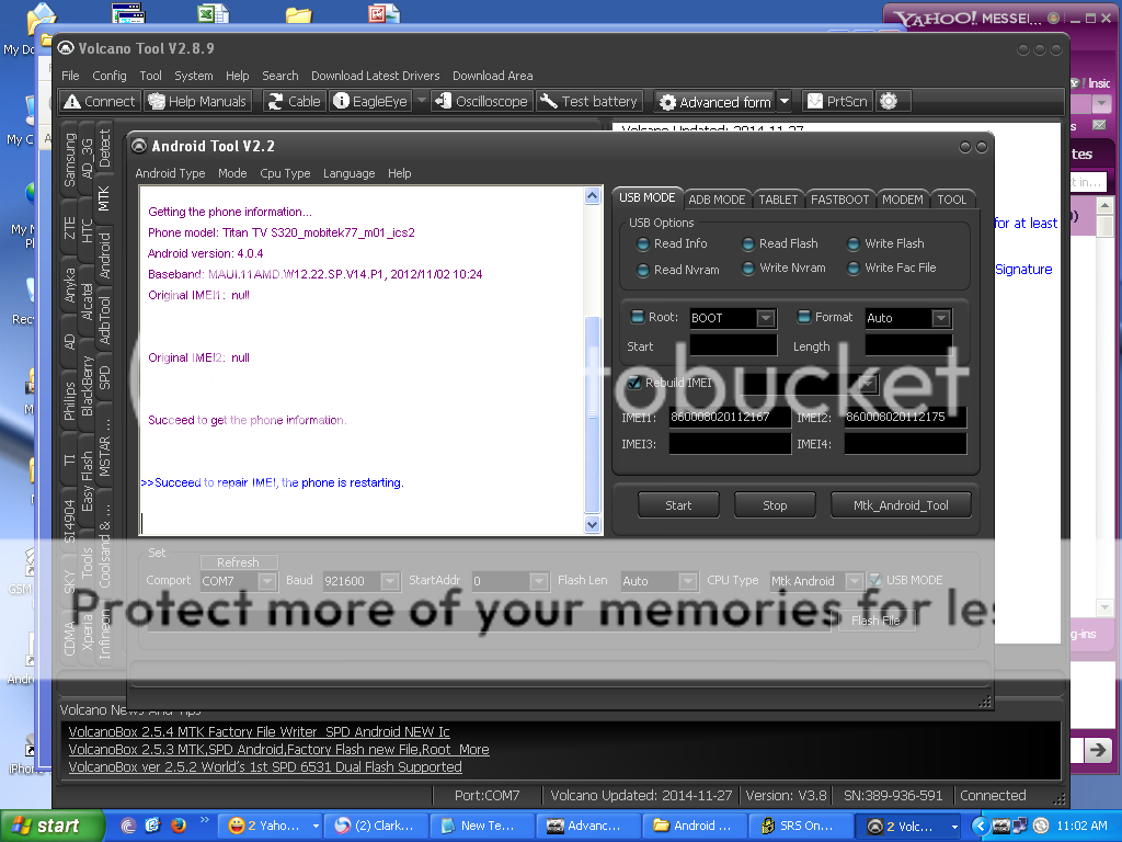

volcano tool

open SRS root tool
conect usb cable
fallow on screen pop up
and wait until proccess done
pagkatapos ang rooting
open volcano tool
click adroid tool
click adb mode
check if have rooted permision is root
go to usb mode
check rebuild imei
put the original imei of the phone
click strart
wait a seconds proccess complete

SRS one click root
volcano tool

open SRS root tool
conect usb cable
open volcano tool
click adroid tool
click adb mode
go to usb mode
check rebuild imei
click strart
