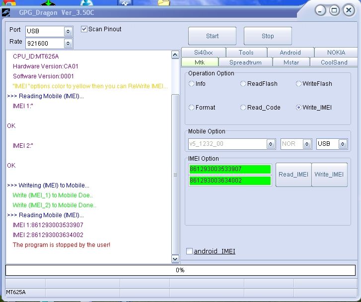

w20 blank imei
Procedure:
open gpgdragon Crack
tick mtk
choose usb
click write_IMEI
start
insert usb ( install driver if necessary )
wait until reach 100%
red color will appear at the IMEI Option box
enter Imei from the back of the phone
now click WRITE_IMEI
wait until finish...
DONE
