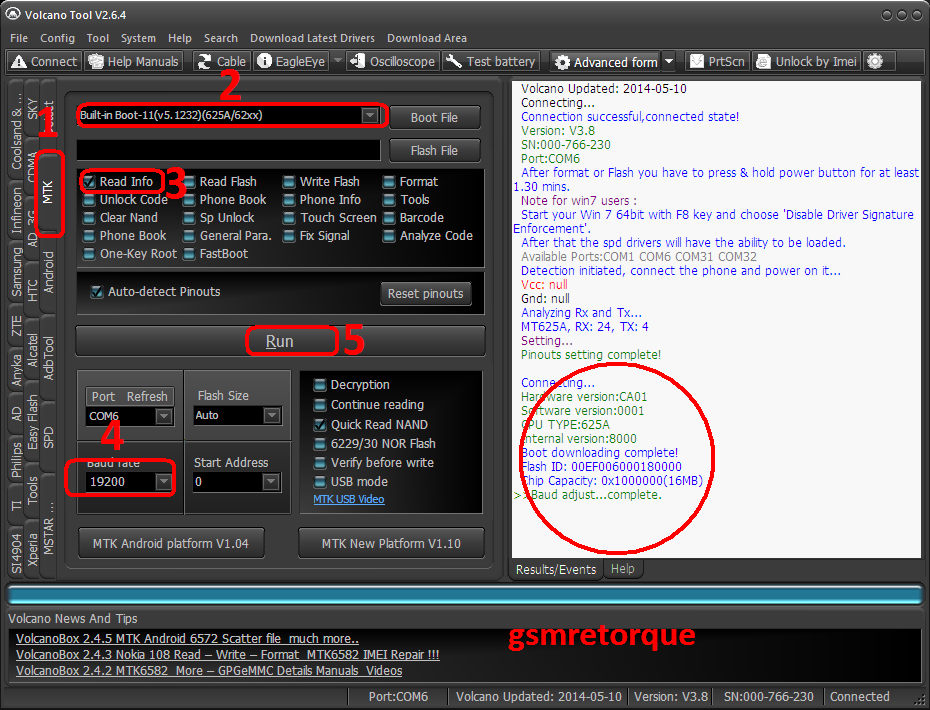

cherry mobile w20 none imei
kaya di maka send ng message kahit recive message ayaw din...

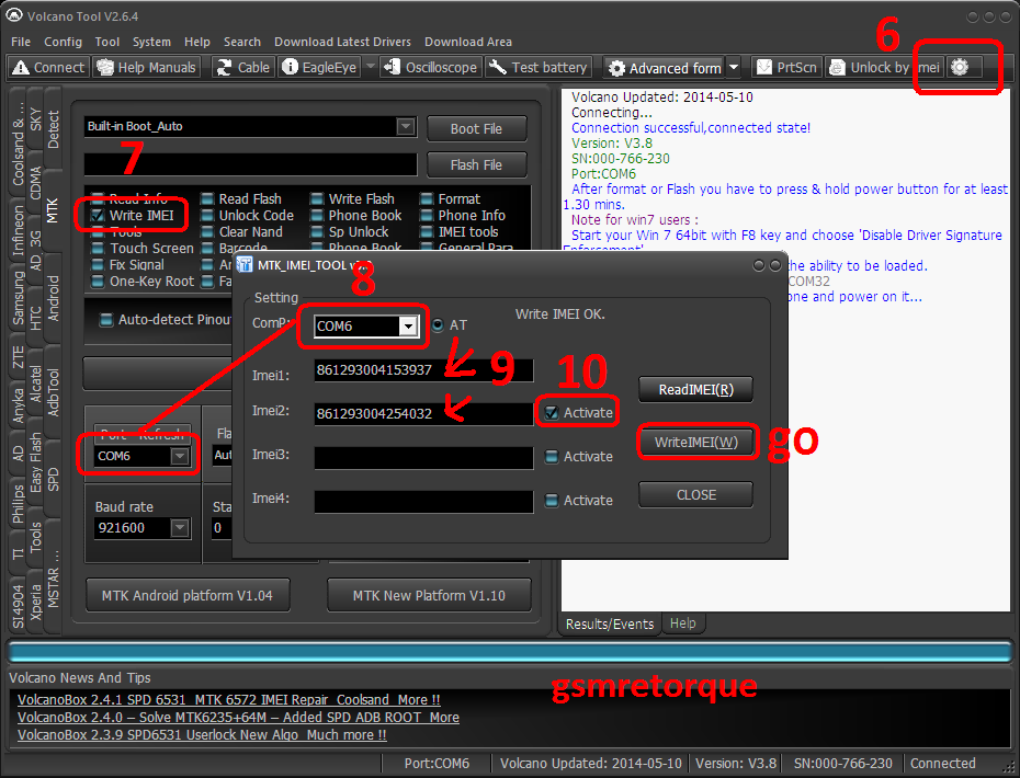

action taken repair imei here at volcano..
see my screen shots
