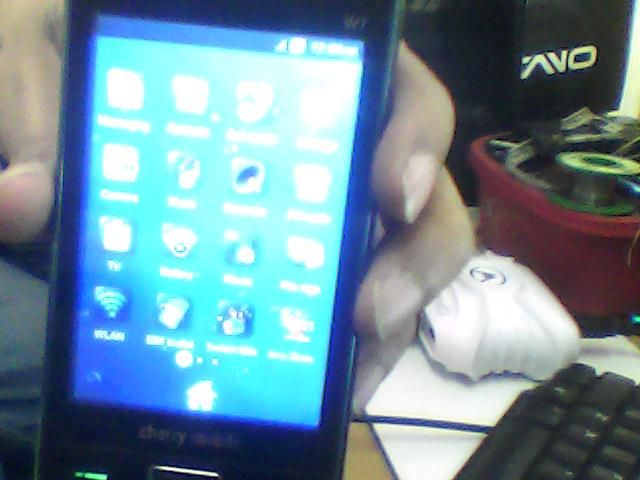

bigla na lng daw nagkagaon

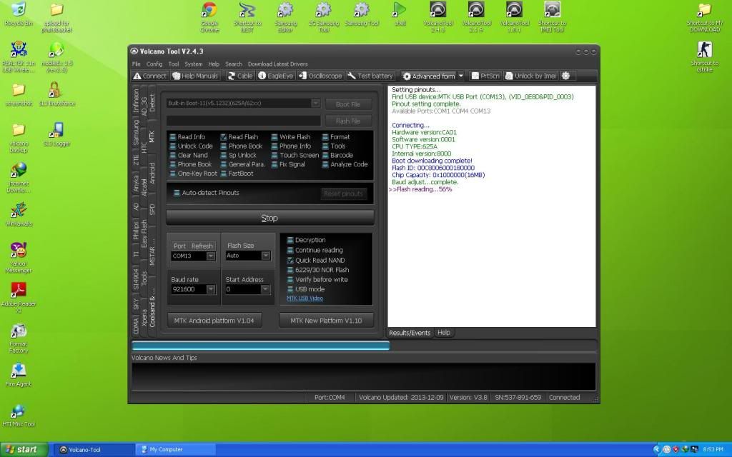

Use P-05B
Click Detect
Cable Auto Select Cable
Detect Type [D+/D-]MTK USB&Mstar(Do find BOOT)
Click Detect
Click Set Pinout
Change Boot To Built-in Boot-11(v5.1232)(625A/62xx)
Check Read Flash
Uncheck Auto-detect Pinout
Click Run

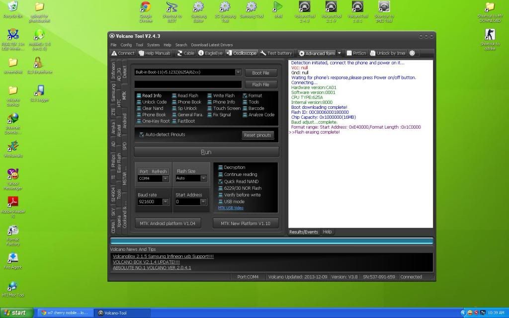

Click Format
Input Start Address(hex) 0xE40000
Input format lenght(hex) 0x1C0000
Click Auto
Done
