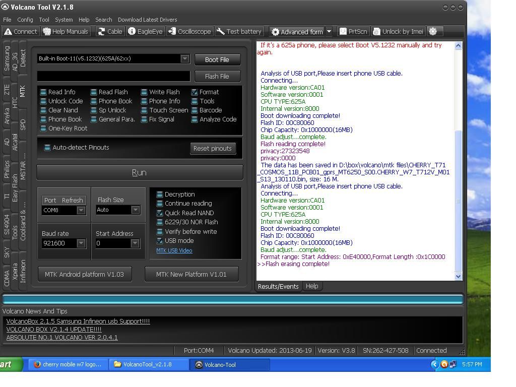

cherry mobile w7 hang done by volcano
1#open volcano box
2#boot file 11(v5.1232)(625A)(62XX)
3#back up read flash
4#format
5#run
Analysis of USB port,Please insert phone USB cable.
Connecting...
Hardware version:CA01
Software version:0001
CPU TYPE:625A
Internal version:8000
Boot downloading complete!
Flash ID: 00C80060
Chip Capacity: 0x1000000(16MB)
Baud adjust...complete.
Flash reading complete!
privacy:27323548
privacy:0000
The data has been saved in D:\box\volcano\mtk files\CHERRY_T71_COSMOS_11B_PCB01_gprs_MT6250_S00. CHERRY_W7_T712V_M01_S13_130110.bin, size: 16 M.
Connecting...
CPU TYPE:625A
Flash ID: 00C80060
Format range: Start Address: 0xE40000,Format Length :0x1C0000
>>Flash erasing complete!

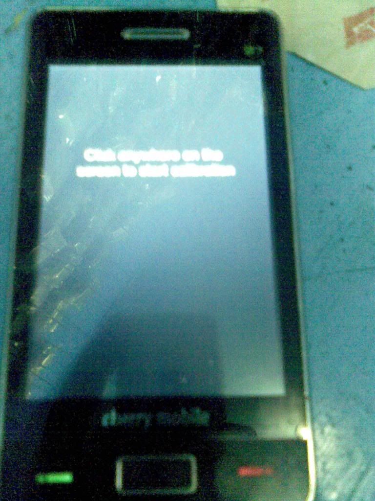

eto na po yun cherry mobile W7 done
