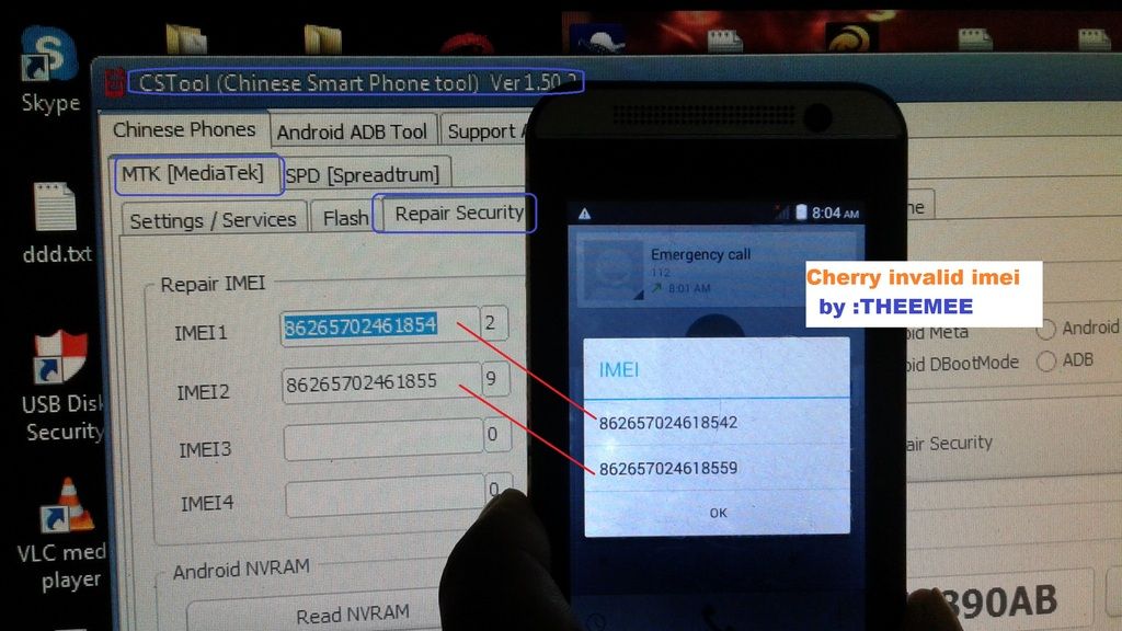

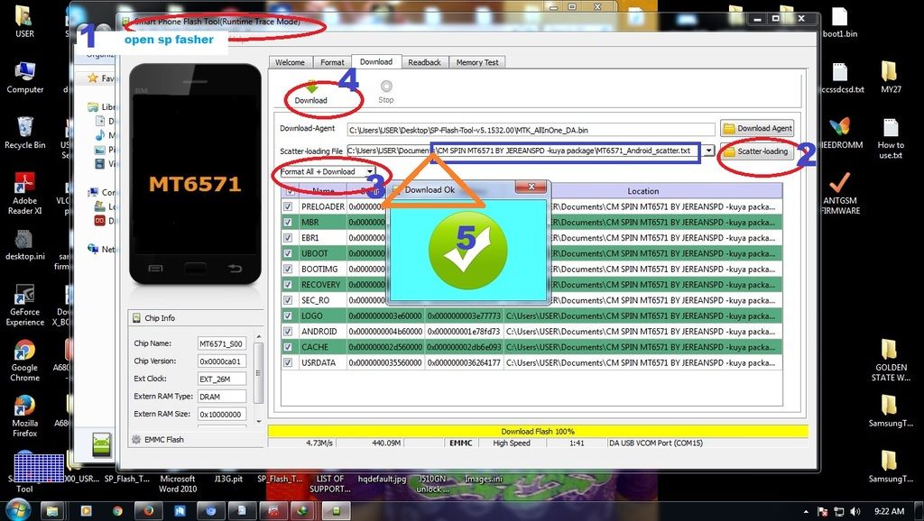

THEEMEE Premium 2024 Joined Sep 8, 2014 Messages 321 Reaction score 11 Points 101 Location surigao city ,surigao del norte Jul 11, 2017 #1 Cherry SPIN flash to sp flasher and rebuild imei at CS TOOL Done Tool & Procedure : nasa screenshoot na po Salamat kay toto27 sa password P400 CHARGE flashing at rebuild kasi
