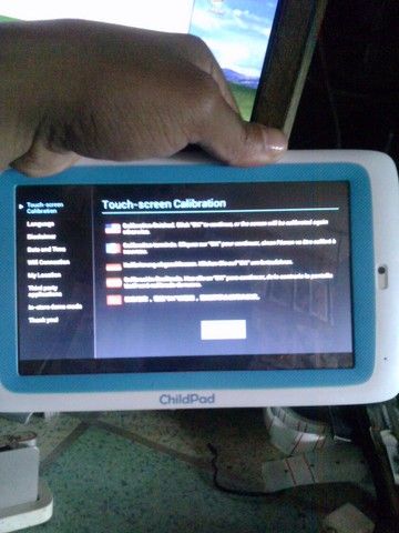

TABLET:
ARNOVA childpad
Problem:
Auto restart

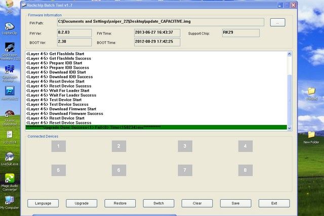

SOFTWARE tool/FW
FW : http://arnovatech.com/support/updates_fwm.html?country=us&lang=en
SW Tool : Rockchip Tool v1.7

>open SW tool
>connect tab, press pow button and reset
>tabelet detected/connected ( install driver if needed nasa Rockchip batch tool )
> load FW
> click Upgrade

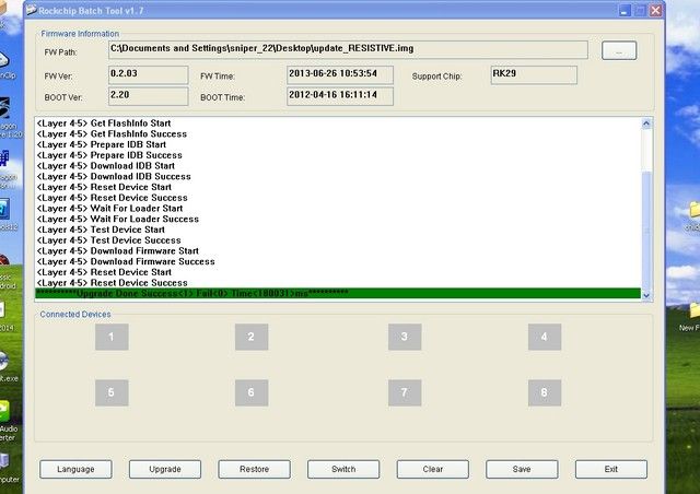

2 ang FW sa CHILDPAD ( RESISTIVE at CAPACITIVE )
first try ko sa RESISTIVE pero ayaw ng touch screen
2nd try, CAPACITIVE..... DONE
