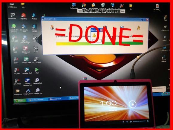

China Tab Share
Problem
Dead Set

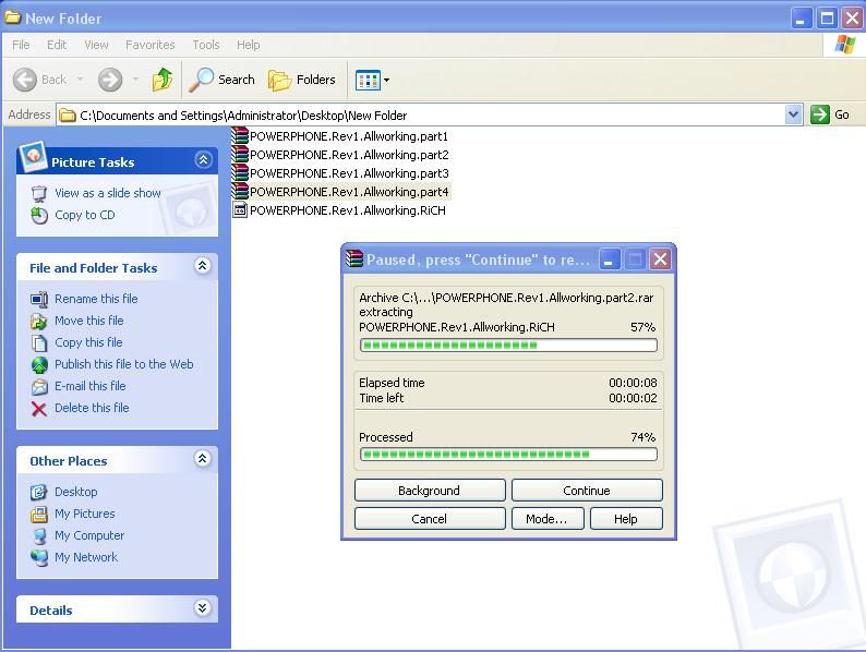

Exract Part 1 to 4

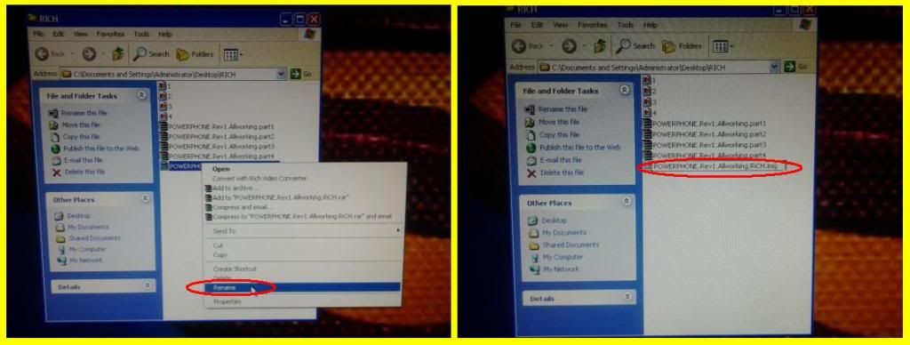

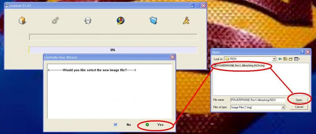

Rename Lagyan Lang Po ng --> .img
Follow Screen Shot

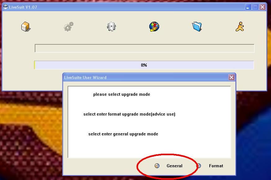

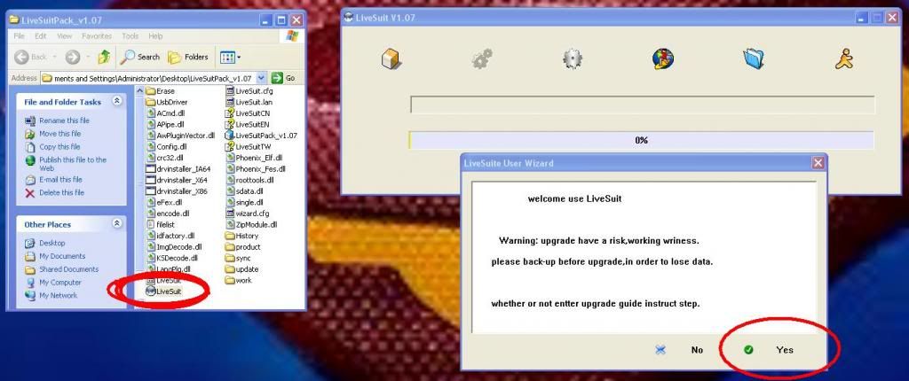

Open LiveSuit /Yes
General

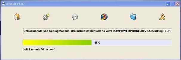

Yes / Puntahan Ang Firmware /Open

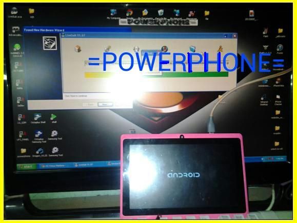

Hold Volume Down /Power On / iLagay ang Usb
iNstall All Driver
Pag Ka install Mo Ng Driver My Mag POP Screen Just Click --> NO

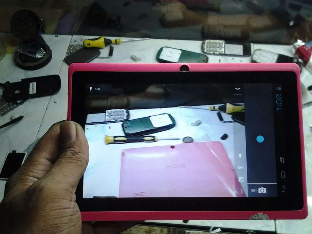

Check Touch Screen Cam / Wifi /etc aLL DONE
