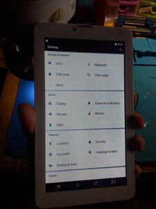

share ko lang po issue nito nag shutdown bigla habang
nakacharge sabi ni tumer

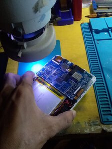

checking:
physical check sa board malinis pa at mukhang bago pa ang unit.
battery may 3v mahigit pa.
charger to battery terminal normal voltage

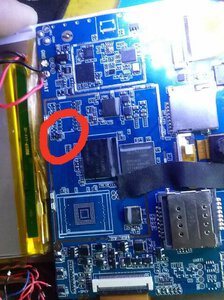

check kung may leak o short via diode mode meron base sa battery terminal meron leak
check buttons kung sira ok naman at may voltahe din
check sa power supply bumibitaw sa power button 0.04amps lang blik 0.00 na ang current.
wala rin mainit na parti.

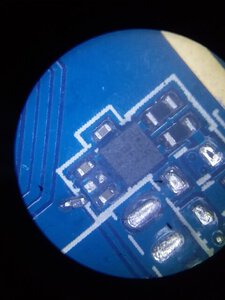

2nd option imanual checking na components at hindi naman nabigo nahuli rin via buzzer mode.
remove caps lang.
done..
