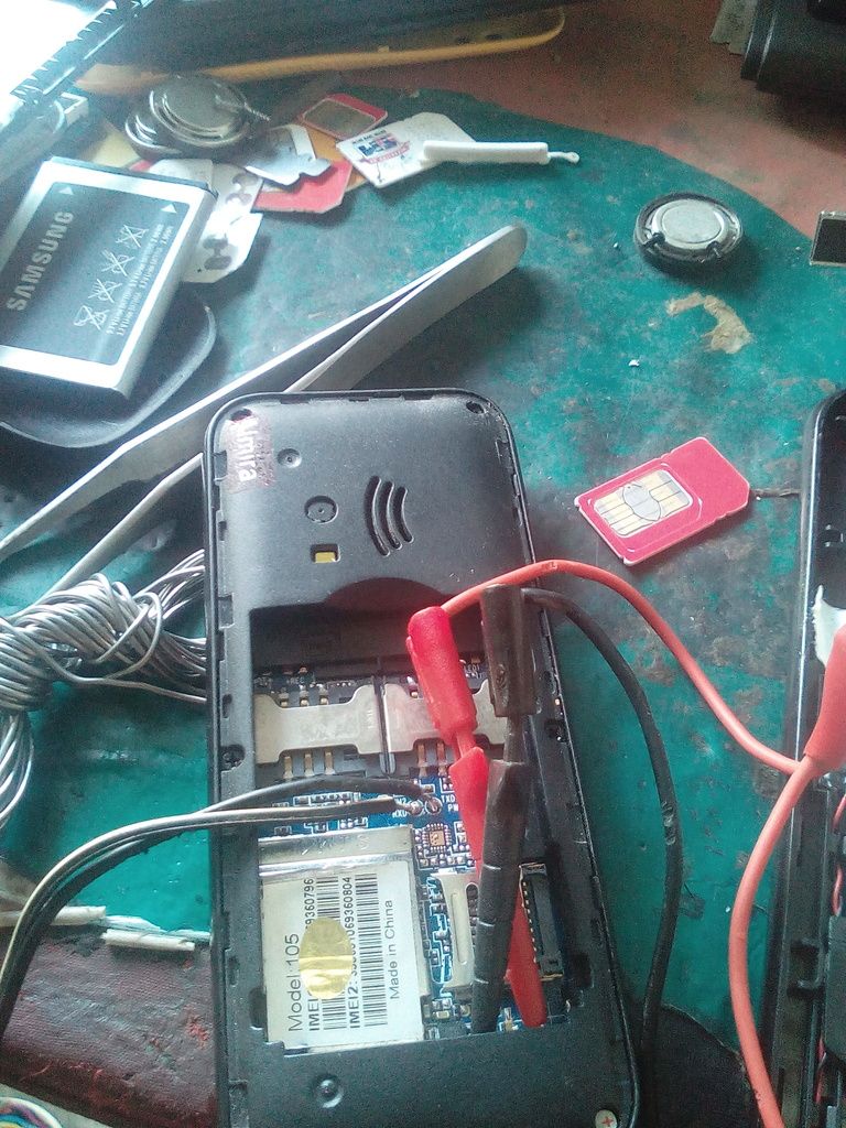

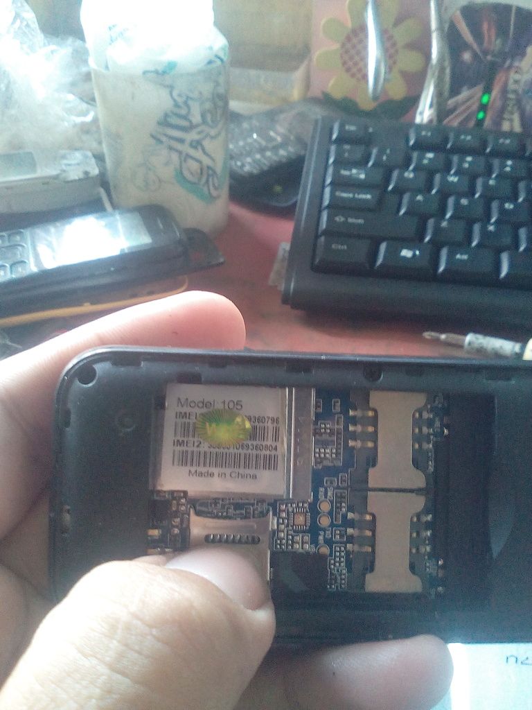

needed tools volcano box..
(Used Utility tool)
Chips set Coolsand and RDA
via RX TX pin.
ganito po

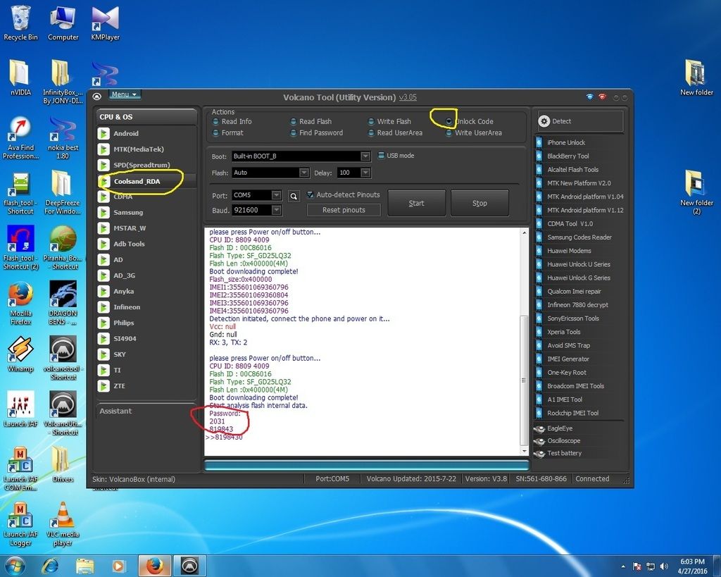

open Volcano Box with Utility tool.tick Coolsand and RDA

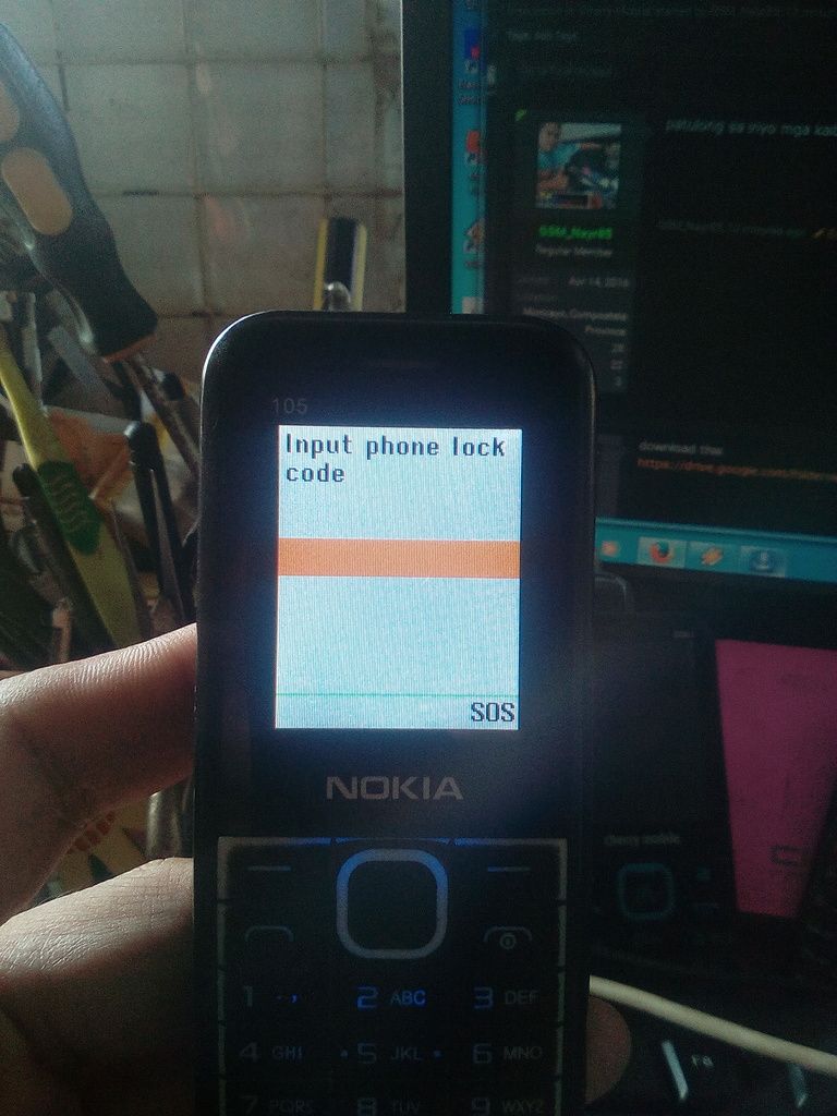

tick Unlock code and then Hit start..ayan at lumabas c number code.

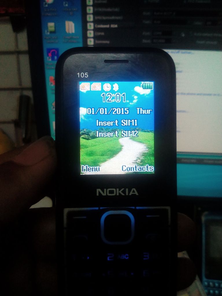

after apply the code,and its Done!
