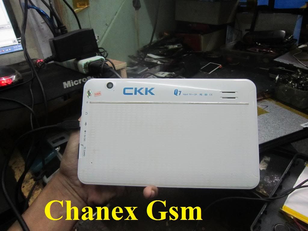

SHARE KO PO CKK Q7 HANG ON LOGO

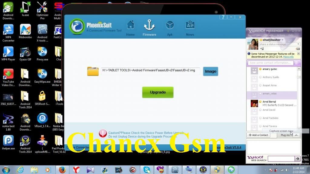

FIRMWARE
TOOLS
OKEY NA BUT I NEED FIX TS KASI INVERT PO

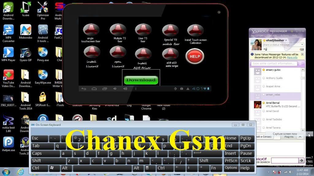

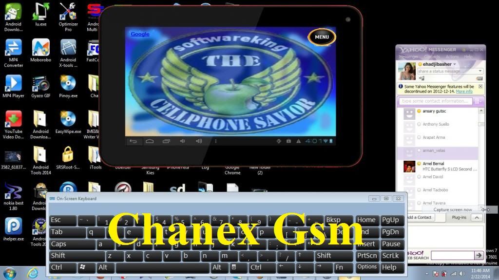

GO TO MENU
SELECT Special TS module fixer
SELECT THE TS ID LIKE IN THE IMAGE

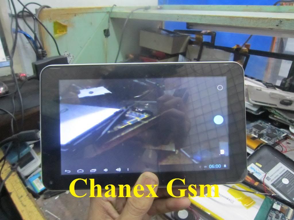

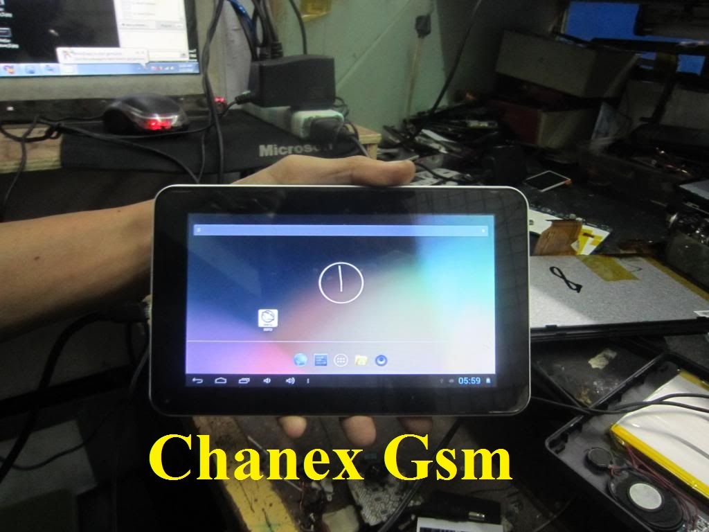

OK NA TRY WIFI
CAMERA
