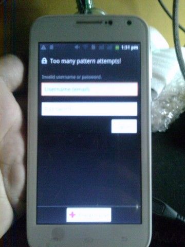

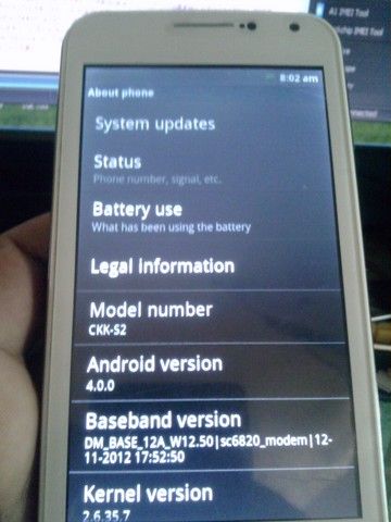

CKK S2 too many pattern, done.
286
287
sniper_22
Oct 5, 2014
73
Unit:
CKK S2
Problem:
Too many pattern attempts
Gadget:
Volcano box
USB cable

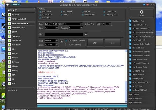

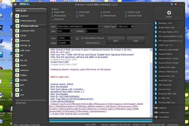

Action taken:
> open volcano software
>Spd
> uncheck auto detect
>boot : 6820/8810
>read info/read flash/FORMAT
>press VolUP connect phone(install driver if needed)
Dahil first time palang may maligaw sa akin na gantong unit
Para siguradong di mag abono sakaling sumablay si bulkan:
ay Kausapin muna si costumer kung gusto nya ilaban phone( patay kung patay :D ).
Pag na dead parang ang hirap pa naman humanap ng firmware na pambuhay.
