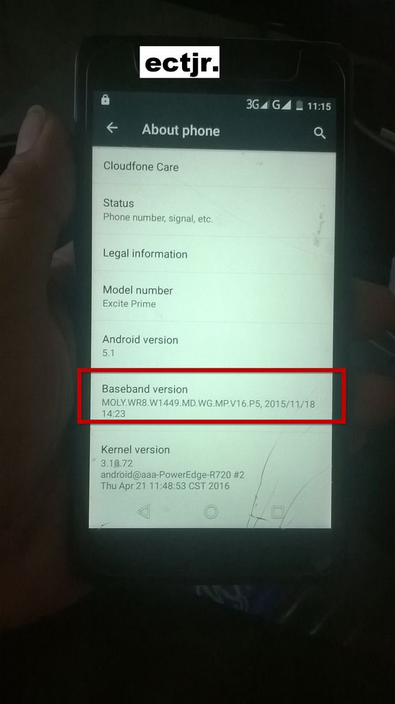

share ko lang po itong gawa ko
Excite Prime

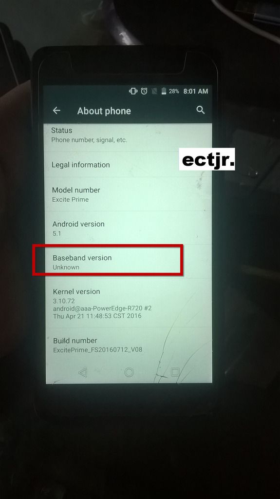

Unknown baseband

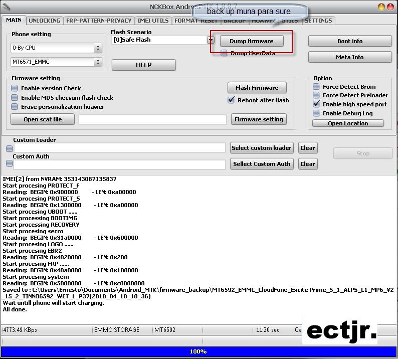

ito po ang pictures and logs
back up po muna para sure via NCKMTK
download link
https://www.4shared.com/rar/pVPyWO3nca/MT6592_EMMC_CloudFone_Excite_P.html?

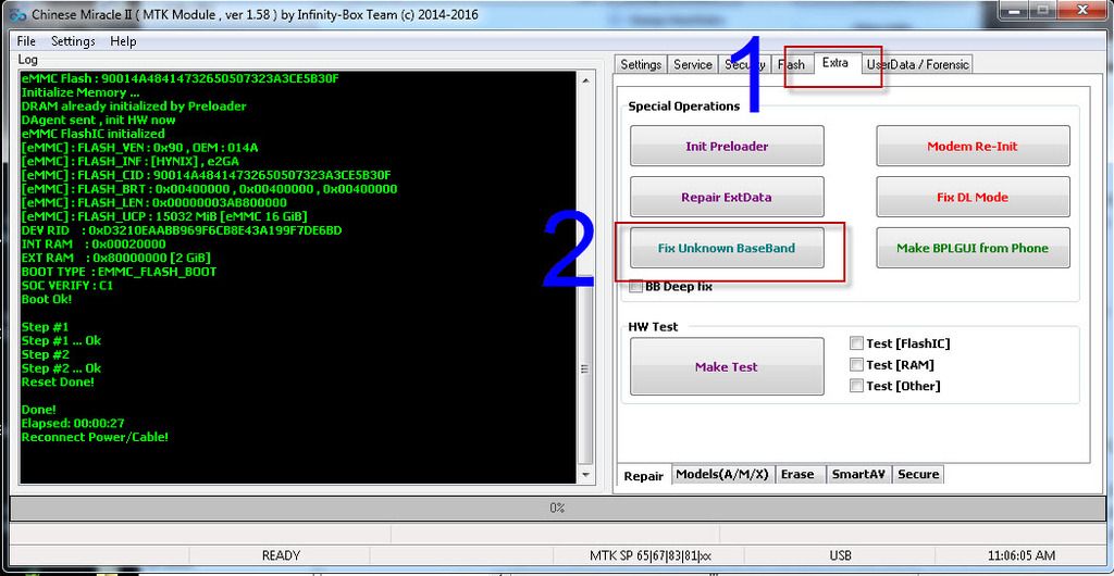

fix unknown baseband
after maifix ang baseband

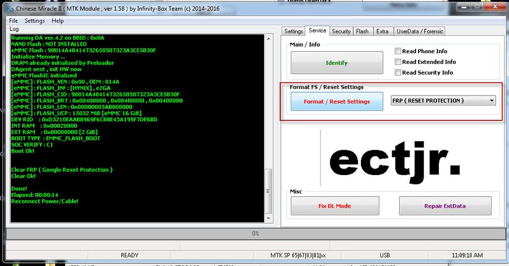

FRP nman kso po hnd ko na napicturan kaya logs nlang po ang reperence ko

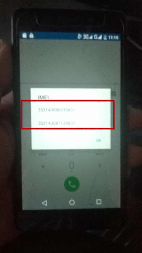

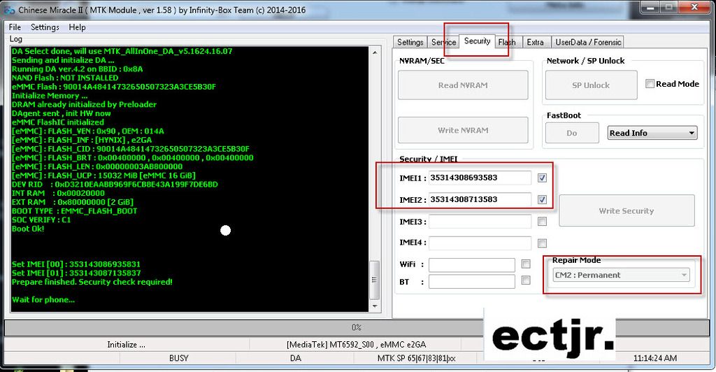

ito napo ang result
pero invalid IMEI pa po sya
DONE na po
sana po ay makatulong
salamat po...........................
