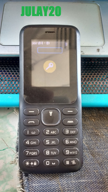

my password ang unit
nakalimotan na lasing daw sya :D
try ko ibat ibang tool SPD ang IC nag run man ang mga tool's na ginamit ko
pero poro error lang
di naka tiis binaklas ko na lang ang unit at ganito

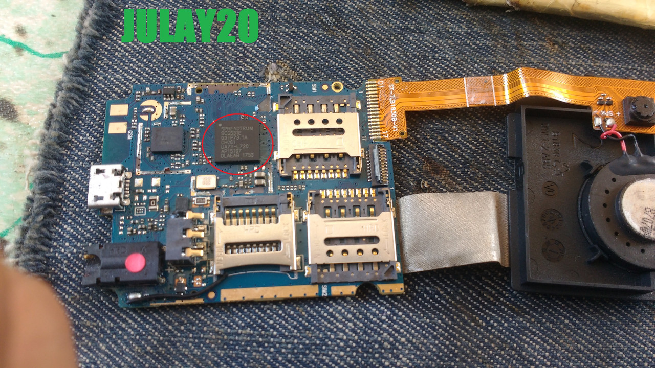

ito yung cp na binaklas ko para makita yung ic para di na kayo ma herapan :P
IC SPREADTRUM
SC3531E
yun madali nalang gawin

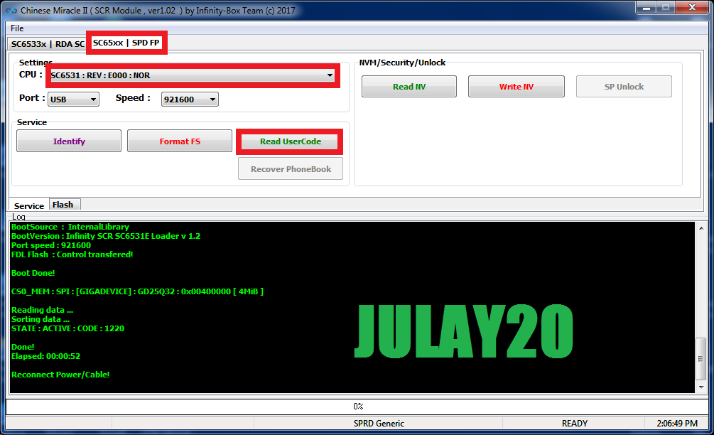

Procedure:
Open CM2 SCR V1.02
Select SC65xx/SPD FP
Settings CPU : SC6531 yung pina ka dolo
Click Read User Code
Saksak usb wait...... di yan mag run :P
Yung port na saksakan ng usb lagyan mo ng led o jumper gaya ng sa mga phonex mobile
yung ground at yung katabi nito lagyan mo led o jumper mo dalawang paa ng charging port wala ako pic
pero alam namn natin kong ano yung charging port diba :P
tapos saksak mona usb wait mo lang ma read ang code
Log's
Code:
Card found : 6CB042B6 , v0136
Infinity-Box Chinese Miracle II : SC/RDA Module [SCR] v1.02
SCRD mode : AUTO
SPRD mode : SC6530 : REV : 0000 : NOR
SPRD mode : SC6531 : REV : E000 : NOR
Operation : Format FileSystem [ v1.02 ]
1. Power off device
2. Press and hold BootKey or use BootCable
3. Insert cable and battery in device!
Wait for device ...
Device Connected!
BootVersion : SPRD3
BootSource  :  InternalLibrary
BootVersion : Infinity SCR SC6531E Loader v 1.2
Port speed : 921600
FDL Flash  : Control transfered!
Boot Done!
Error : PMT info not found! Damaged device MCU code!
Send log and report.log to support! Include device info also!
Reconnect Power/Cable!
Operation : Read UserCode [ v1.02 ]
1. Power off device
Wait for device ...
Device Connected!
BootVersion : SPRD3
Port speed : 921600
Boot Done!
CS0_MEM : SPI : [GIGADEVICE] : GD25Q32 : 0x00400000 [ 4MiB ]
Reading data ...
Sorting data ...
STATE : ACTIVE : CODE : 1220
Done!
Elapsed: 00:00:52

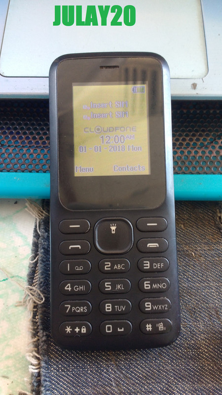

lagay ang password
go to settings factory reset mo nalang para wala ng password :D
