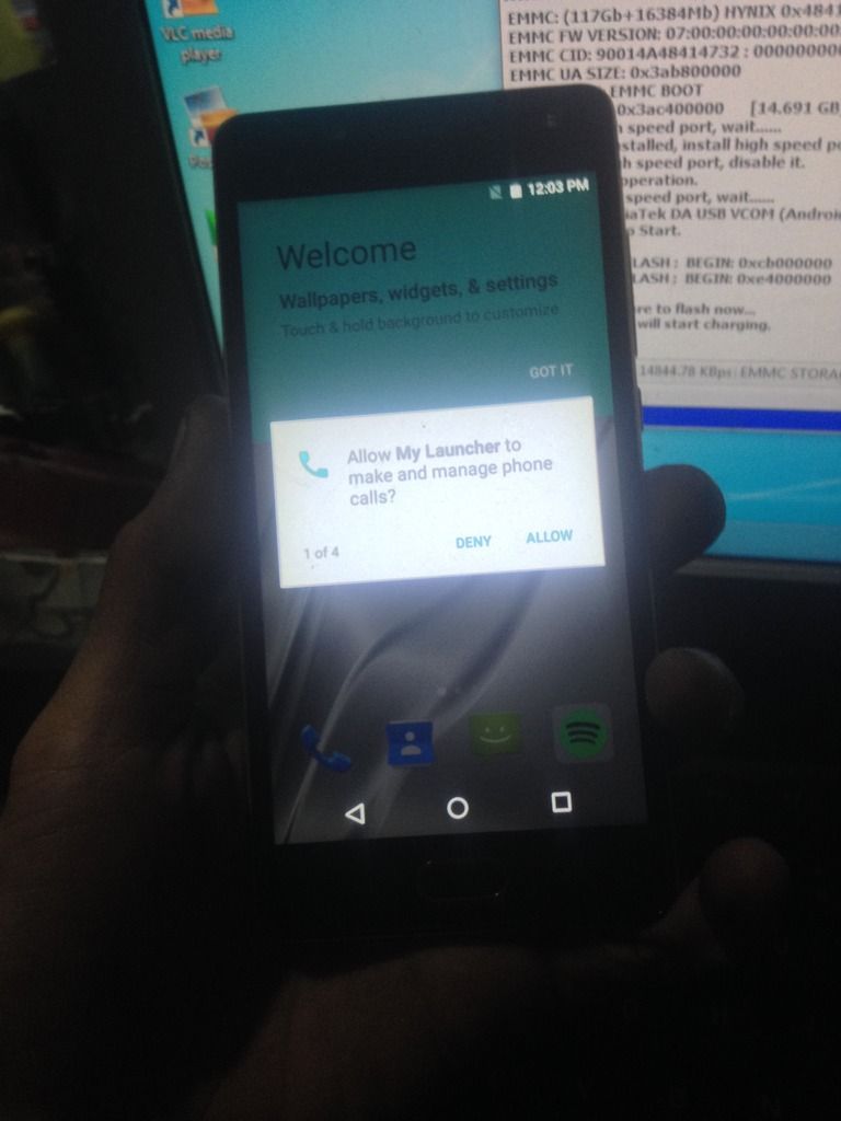

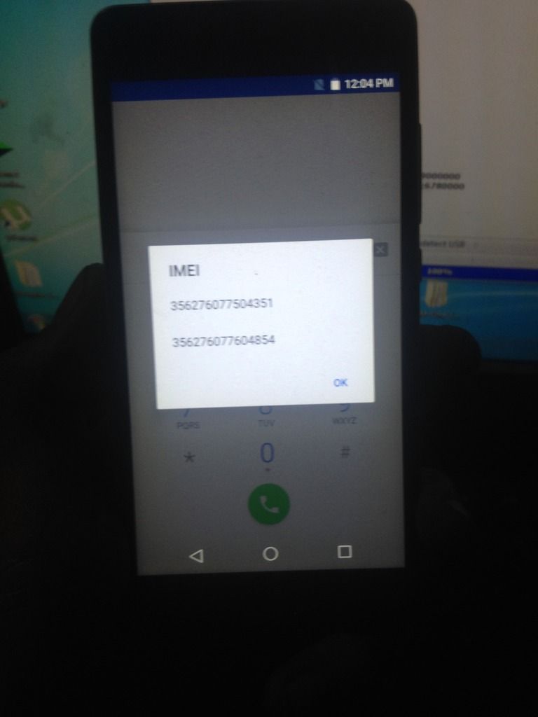

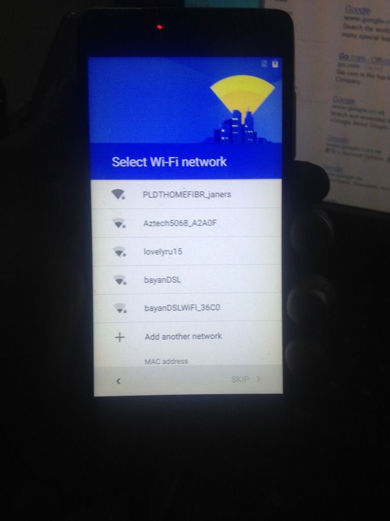

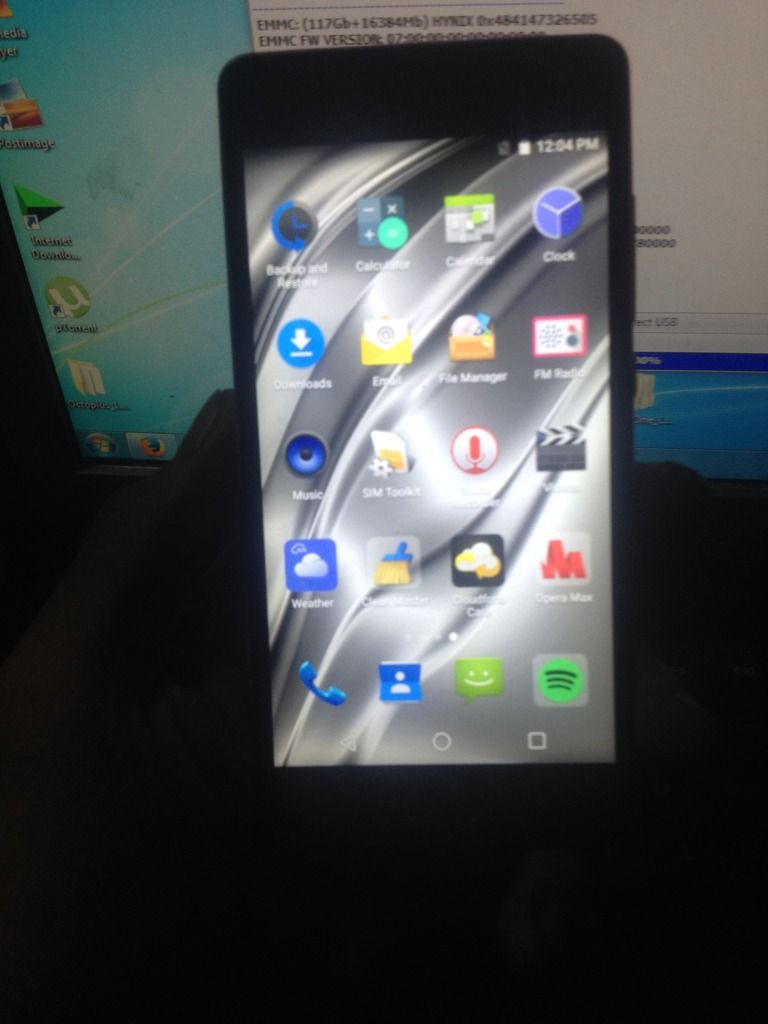

Share ko lang mga boss Gawa ko Kanikanina lang,,CLoudfone Thrill Access FRP problem DONE!!
Working Po LAhat

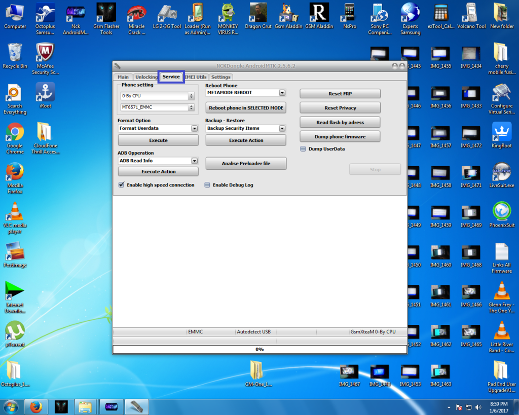

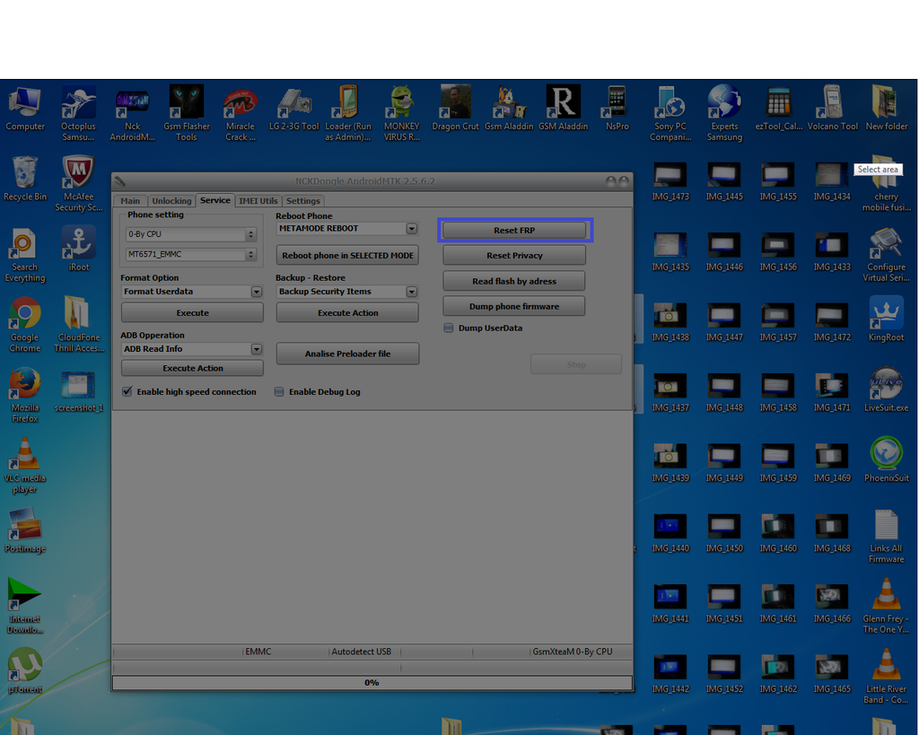

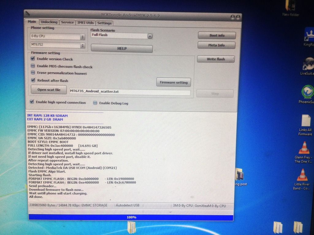

PROCEDURE:
open NCK Crack, then go to MTK.then Set to. MT6752 after that go to`` SERVICE``& `` RESET FRP``
Power Off unit
HOLD - V

BEFORE & AFTER
Soryy hindi ko na picturan ung Pag flash ko Sa `` RESET FRP``
PAG-KATAPOS NGA PALA NG FLASHING NG FRP MAY ERROR NA LALABAS.
PERO DON`T WORRY MAY PANG FLASH TAYO NYAN>>
SHARE KO NALANG PO LATER!!!

Wifi

imei
