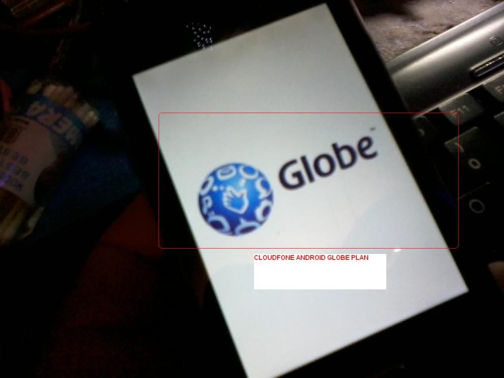

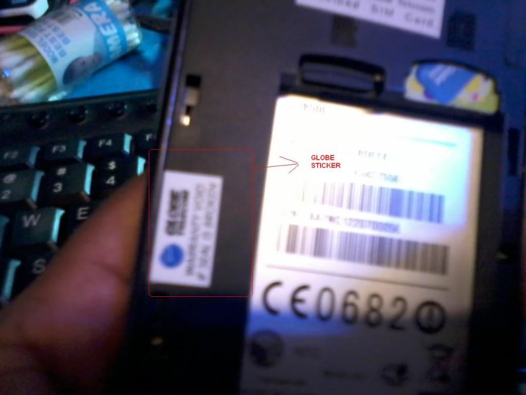

History: Globe Lock.

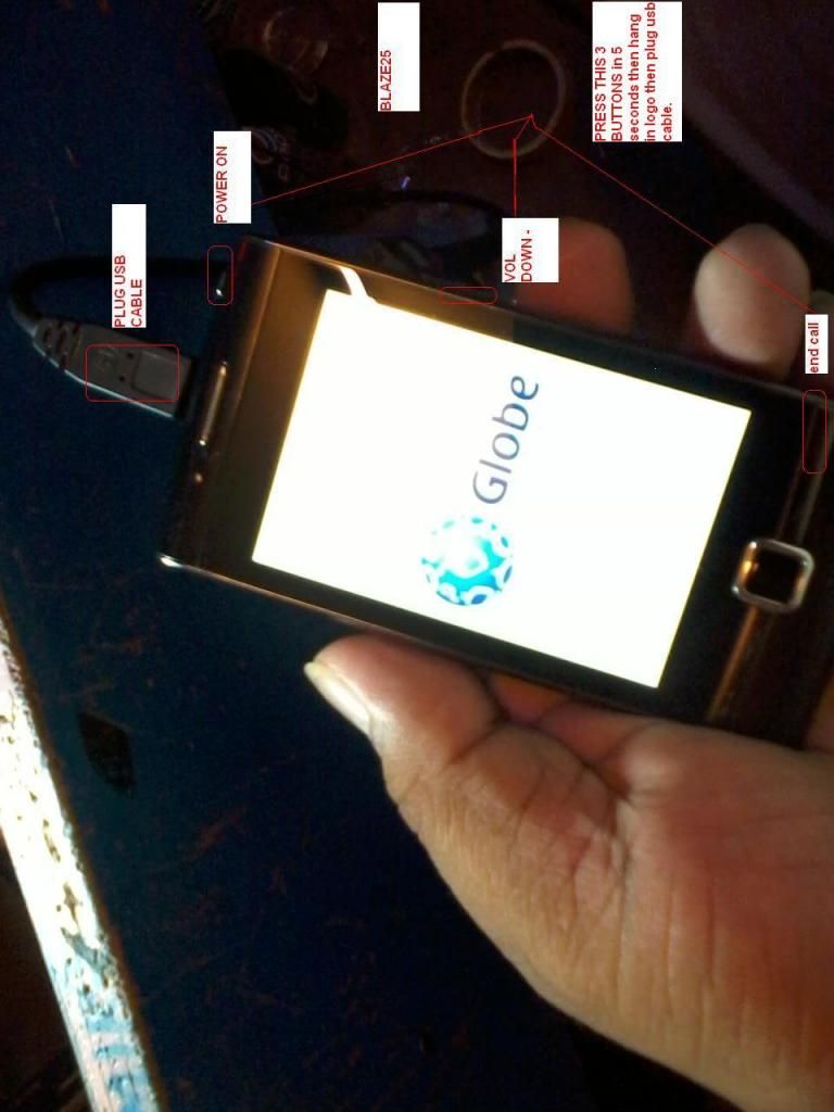

1.Remove Sim and Sdcard
2.Put baterre
3.Press End Call + Vol Down + Power On
4.Wait Hang in LOGO
5.Plug Micro USB

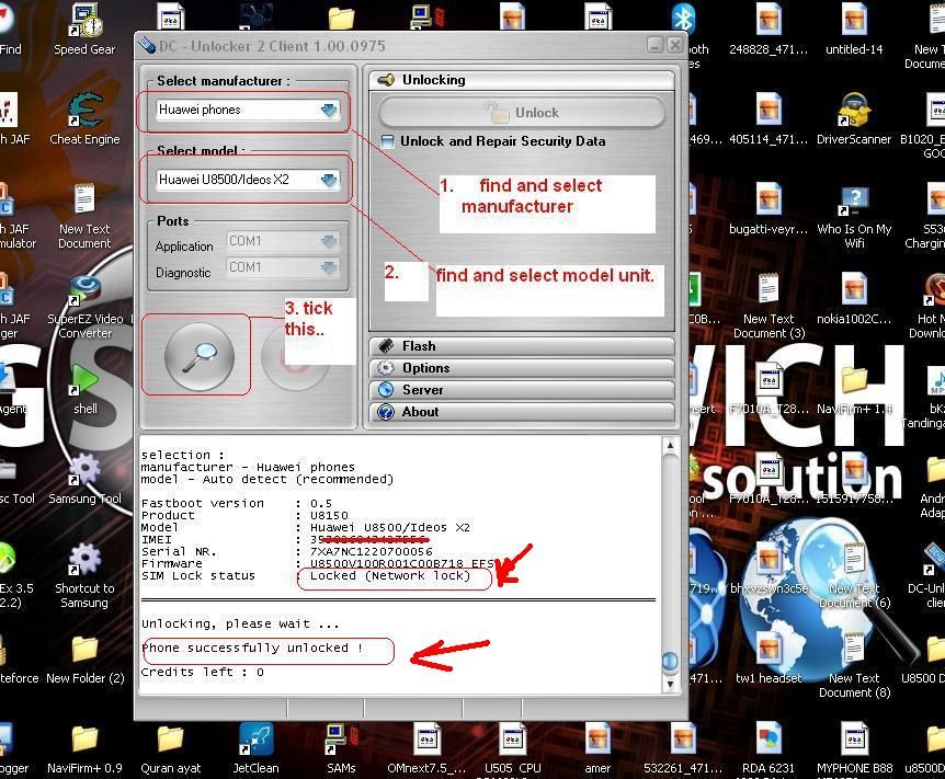

6.Open Dcunlocker Sw
7.Select Manufacturer and Model
8.Tick SCAN
9.But Before you tick scan TAB make sure na naka LOG IN na DCUNLOCKER SW mo or else di siya madetect ng dcunlocker sw pag di ka naka log in at para di po magaya ng pics sa baba na di madetect ang unit..
Success:
