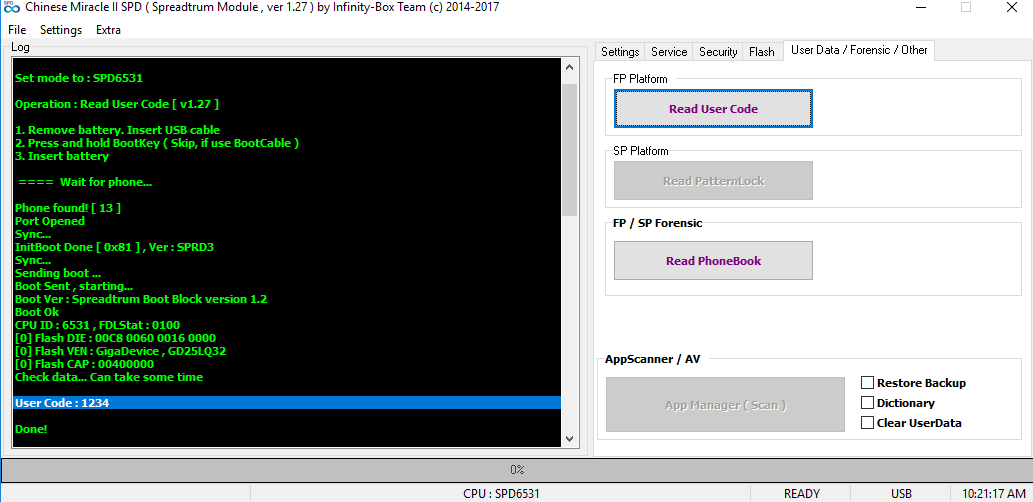

- SOLUTION : Read User code via CM2
- PROCEDURE
1.Open CM2
2. Select Chip
3. select User Data/ Forensic Tab
4. Read Usercode

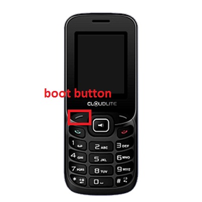

5. Hold Bootkey then Insert cable
6. Wait till Done
