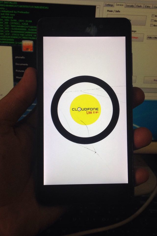

CLOUDPHONE EXCITE PRIME V1 HANG DONE CM2

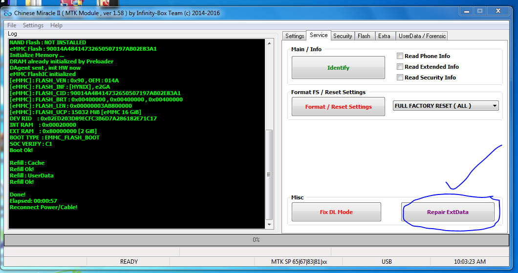

in easy way no need to flash
screenshot procedure
open cm2 mtk
choose boot
punta sa service tab
then hit repair extdata
then salpak usb wait until finish
done

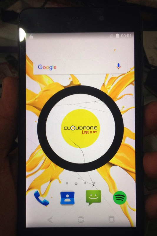

finish product no need to flash
