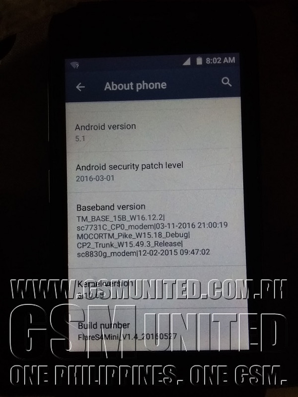

History: Hang on logo.
Taken: Hardreset lang press volume down + power. Backup ko na rin para sa future.
Created by Infinity-Box © Chinese Miracle II © 2017
Device Brand : Flare_S4_Mini
Device Model : scx20_sp7731ceb
Device CPU : sp7731ceb
Device IntName : Flare_S4_Mini
Device Version : 5.1
Device Compile : 5/27/2016 2:18:16 AM
Device Project : FlareS4Mini_V1.4_20160527
Device ExtInfo : Flare_S4_Mini
