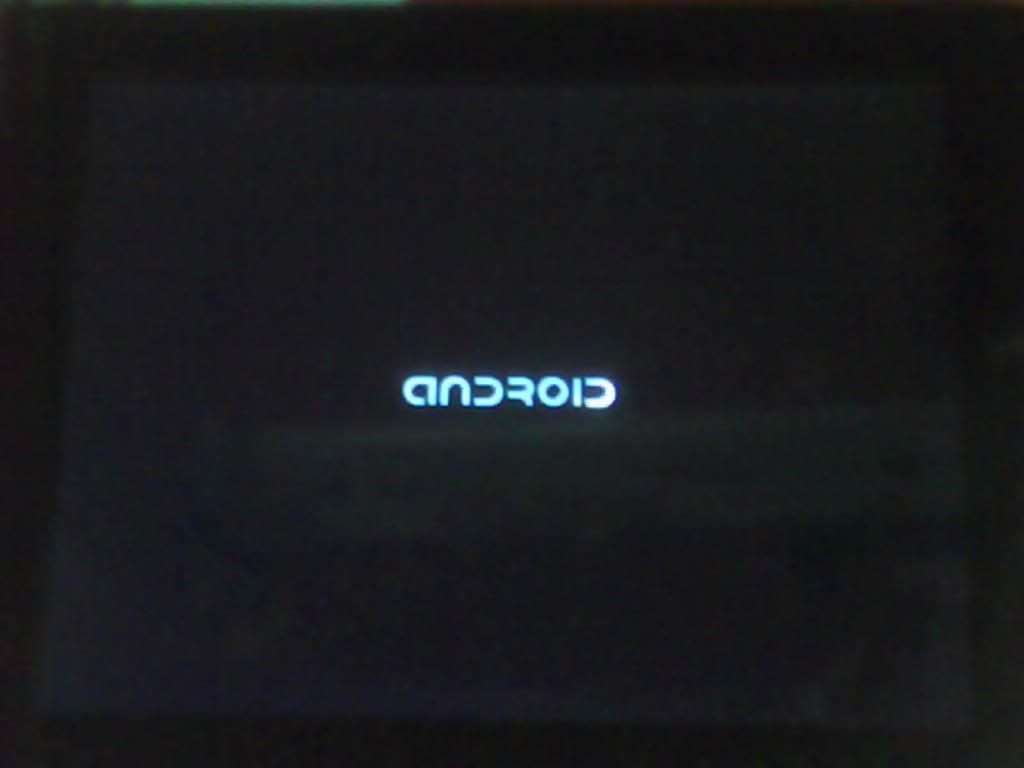

Problem: Hang on Andriod
action taken, first dissmantle the unit and i saw the chipset was allwinner a10 goto computer at salpak sa usb and try to wipe but no luck dahil hindi naka debug ang unit...
so isip again and try ko sana iflash na... but wait isip ulit...

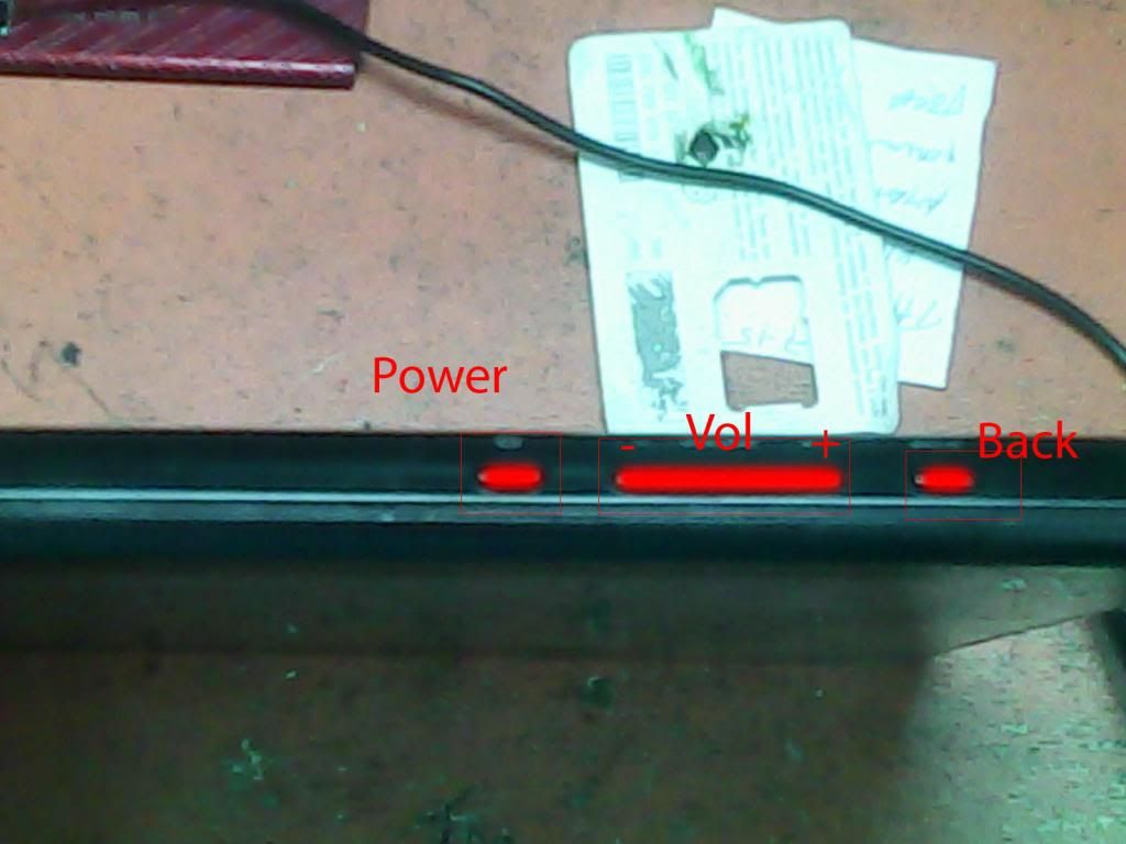

try ko muna kaya ang mga buttons... at di ako nabigo nakatsamba pa...
eto sya...

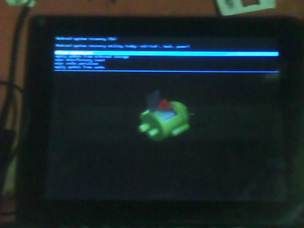

Press and Hold the Volume Up + power... release the power button after lumabas ito.
hanap agad sa wipe data/factory reset... at ayun shoot sya
done!!!
