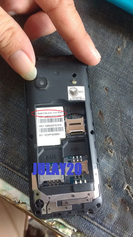

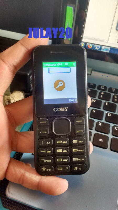

post ko lang mga boss my password po yan
dinala na ni tumer sa iba pero di kinaya :D kaya try ko kong kakayanin ba =))
kinaya namn pero midyo matagal kc nahirapan din ako sa pag hanap ng boot key nito ito ginawa ko
hinanap ko ang boot key lahat ng button pinindot ko na ayaw talaga na isip ko baklasin ang unit kinaosap ko mona ang tumer sabe ok daw boksan :D

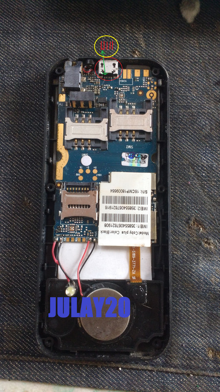

open sm2 spd boot 6531
bokasan ang unit :D
sondan mo to ohh nasa pic:D
lagyan ng led yung dalawang pa nito sa grund at yung katabe nito
salpak usb lagyan ng battery hantayin lang mag done :D

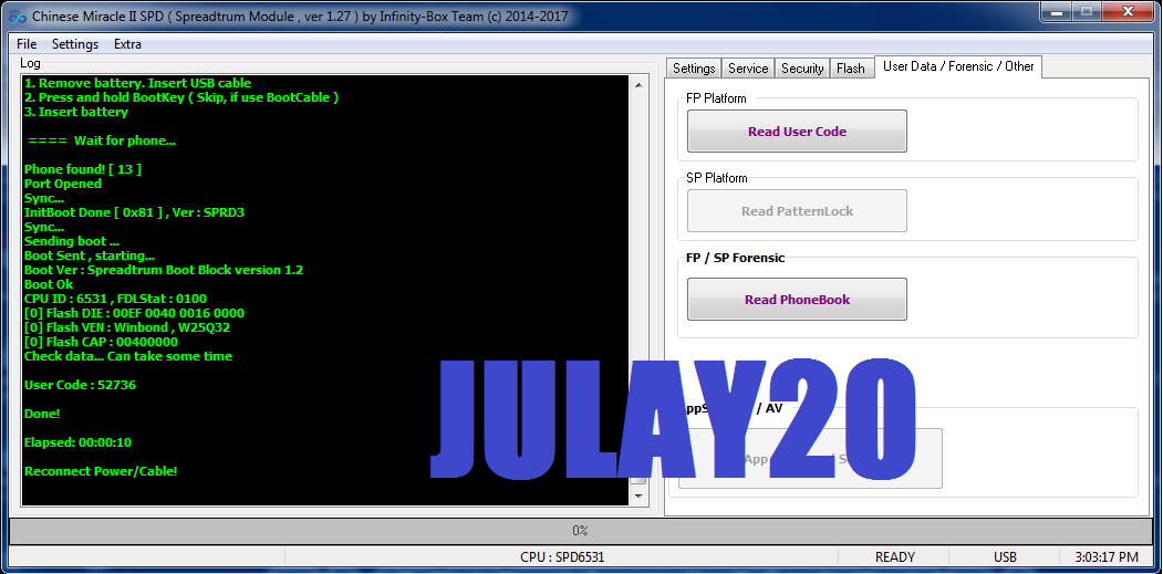

CM2 INFO:
Code:
Operation : Read User Code [ v1.27 ]
1. Remove battery. Insert USB cable
2. Press and hold BootKey ( Skip, if use BootCable )
3. Insert battery
 ====  Wait for phone...
Phone found! [ 13 ]
Port Opened
Sync...
InitBoot Done [ 0x81 ] , Ver : SPRD3
Sync...
Sending boot ...
Boot Sent , starting...
Boot Ver : Spreadtrum Boot Block version 1.2
Boot Ok
CPU ID : 6531 , FDLStat : 0100
[0] Flash DIE : 00EF 0040 0016 0000
[0] Flash VEN : Winbond , W25Q32
[0] Flash CAP : 00400000
Check data... Can take some time

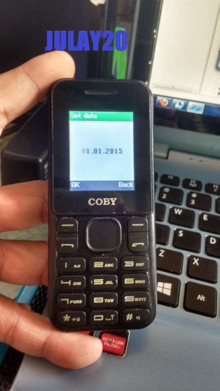

[B][COLOR="Red"]User Code : 52736[/COLOR][/B]
Done!
Elapsed: 00:00:10
Reconnect Power/Cable!
done sana maka tolong
