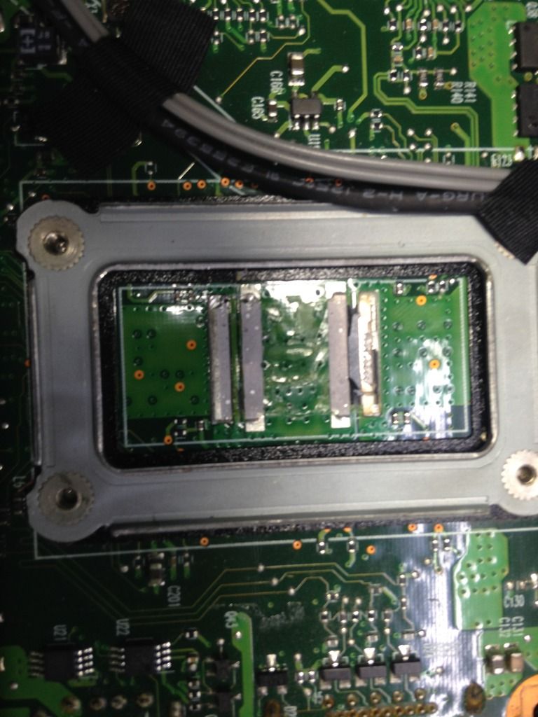

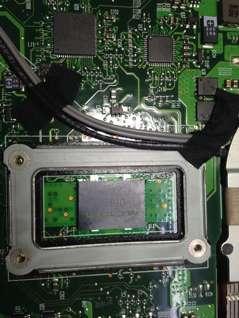

compaq presario..power failure problem..
done via hardware...
procedure...

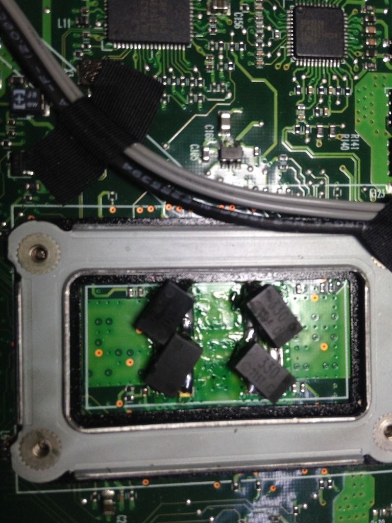

remove this..nectokin..
replace 4pcs..capacitor,,

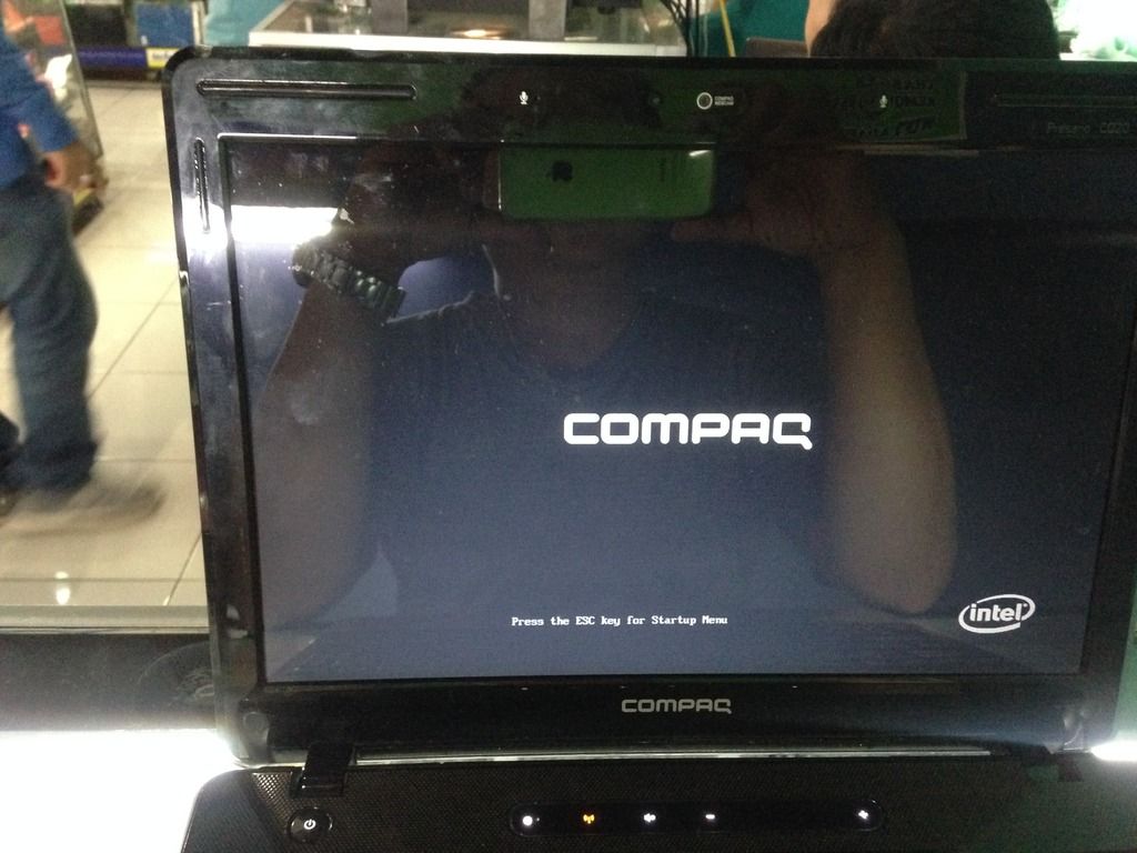

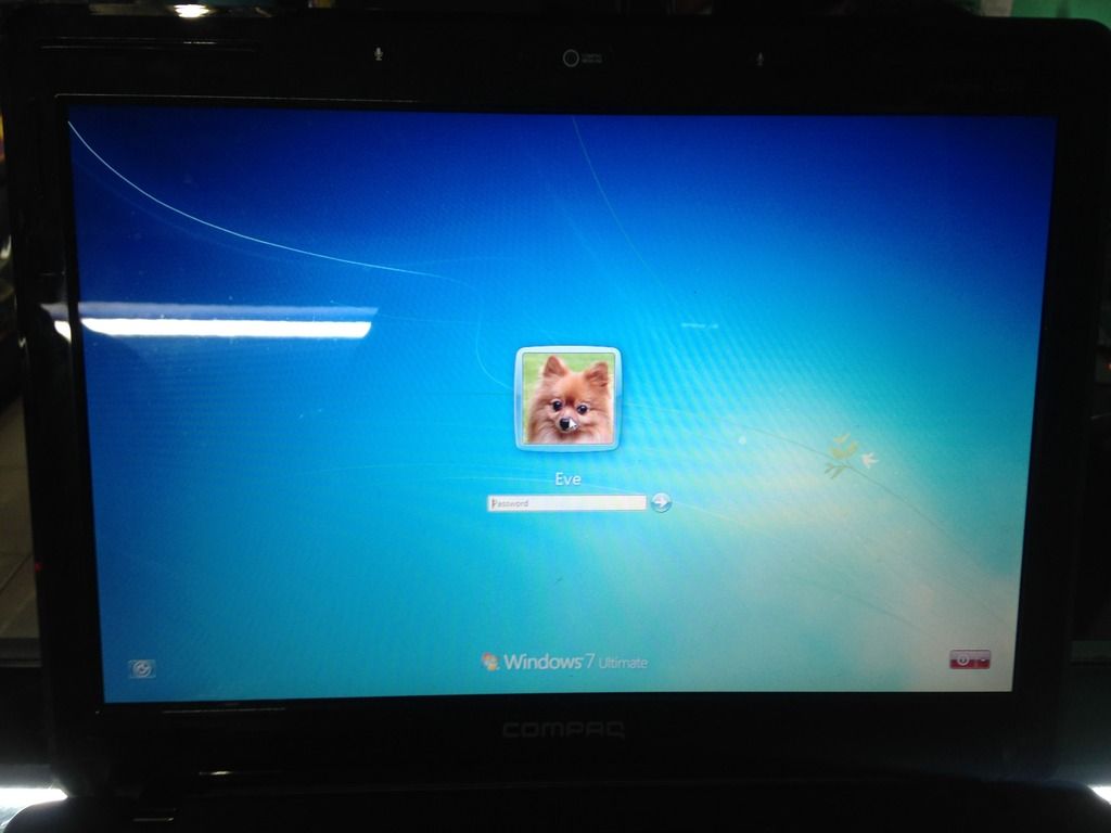

eto napo pagkatapos...may buhay..napo..
sameple lng nagawa sana po..
