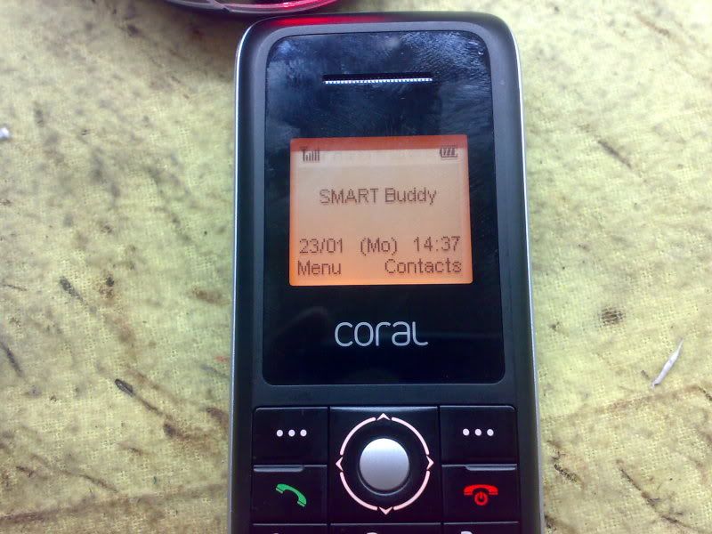

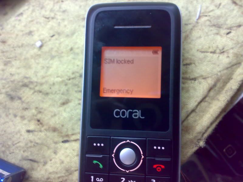

Coral 100 lock from Digitel
share ko lang mga ka GSM

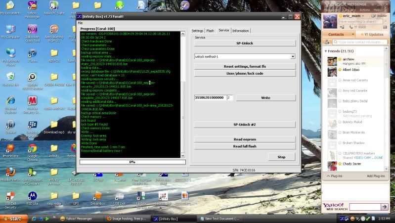

tools:
infinity box
open infinity
select propermodel
go to service
safety first back up muna bago unlock
then tick SP unlock
screenshot

ETo Logs nya
COM9 [VCP0] selected
module v1.73
Device: Coral-100
Checking data, wait...
Action: "sp-unlock"
unlock method-1
Boot ...
Press and HOLD Power button now !
e-gold: 820000
loading...
next part...
boot answer: 01
Release Power button now
Boot Done
Set Baud ...
115200
Set Baud Done
Connecting ...
flash: 0001:22C4
Connecting Done
Check hardware ...
sw version: -DG-P108A1V1.0.0B04 09 39 04 04.12.00 18.26.11 08.02.00 Jul 24 2
Check hardware Done
Check parameters ...
Check parameters Done
backup critical area ...
reading eeprom-static...
file saved: c:\InfinityBox\Pana01\Coral-100_eeprom-static_20120123-144010.B1E.bin
loading data...
wrong database file: c:\InfinityBox\Pana01\z125_eep65535.cfg
error: can't load database v.11
reading eeprom-security...
file saved: c:\InfinityBox\Pana01\Coral-100_eeprom-security_20120123-144011.B1E.bin
reading eeprom-complete...
file saved: c:\InfinityBox\Pana01\Coral-100_eeprom-complete_20120123-144017.B1E.bin
reading additional data...
file saved: c:\InfinityBox\Pana01\Coral-100_lock-area_20120123-144036.B1E.bin
backup critical area Done
Check memory ...
lock found
lock type #1 found
Check memory Done
Write ...
Erasing: lock-area
Writing: lock-area
Write Done
Finished, time used: 1 min 7 sec
Remove/Install battery now !
