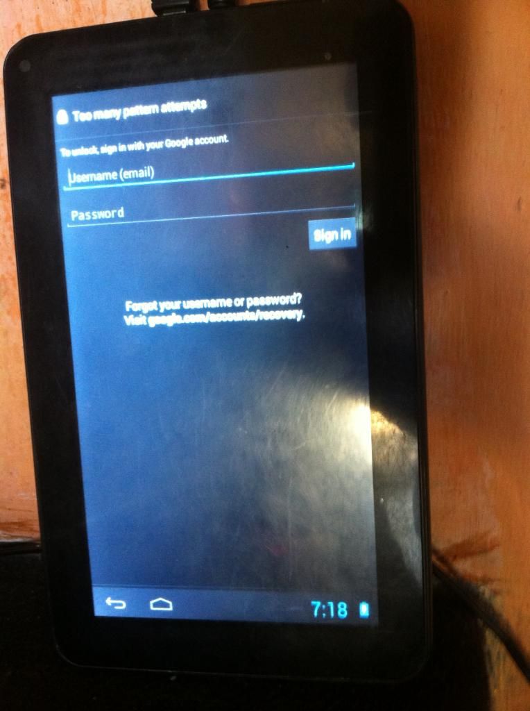

corby tablet pattern rk 2926 wipes tool done

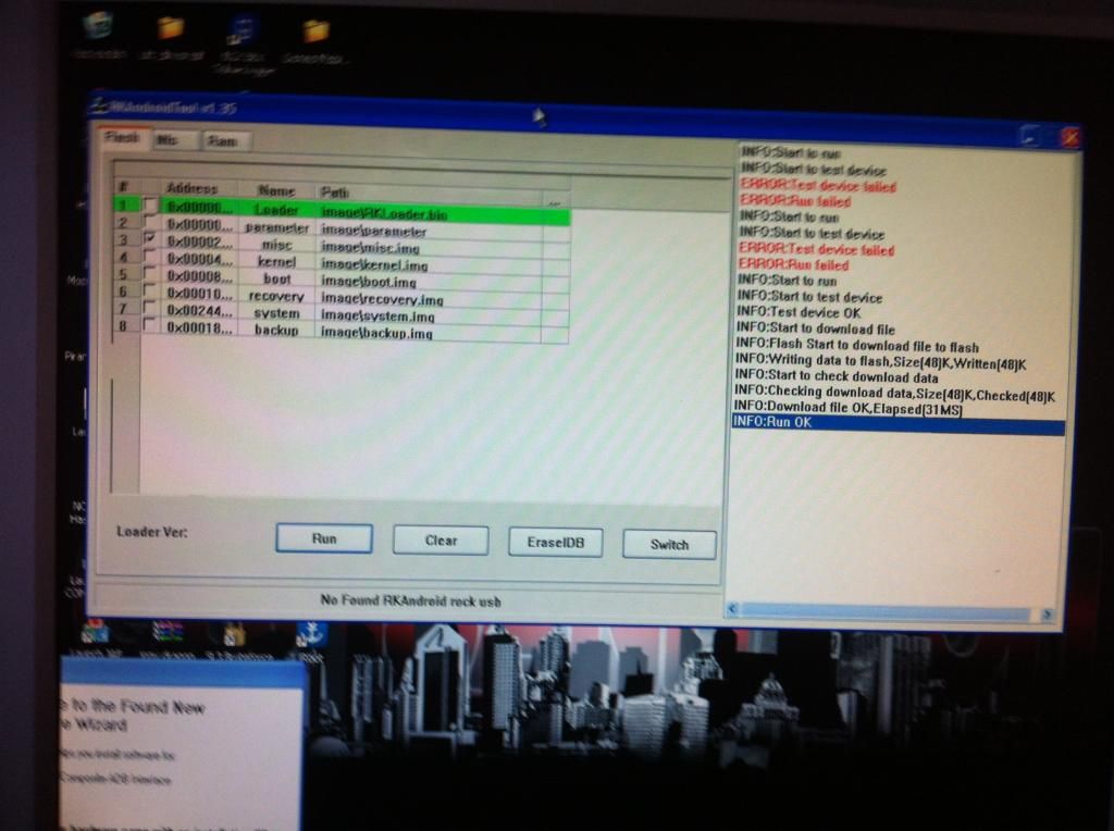

corby patter done rk wipetool
Format:
1.connect to PC with USB data cable
2.some android tablet or handset need charger
3.connect with charger and USB data cable
4.press and hold volume UP + Power key or Volume Down + power key
5.now found new hardware option show
6.install driver Downlod tool and drivers
7.open rockchip android tool
8.you see "rockchip device connected"
9.now select misc.img file
10.untick all file
11.tick only misc file
12.click on "run"
13.misc file flash and your device restart
14.format or hard reset done
http://blueprival.com/v20769?self_r.../download/00109/DlR/RockChip_Android_Tool.zip
sundan lang nsa picture ....install lang driver kasama sa tools
