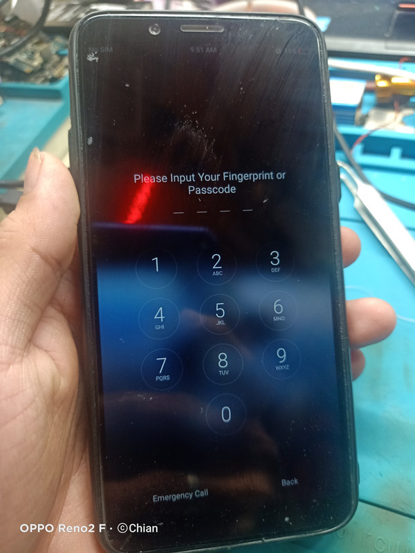

Good day po sa inyong lahat. Today may tanggap po akong unit cph1723 (oppo f5) password problem
Process po agad tayo.

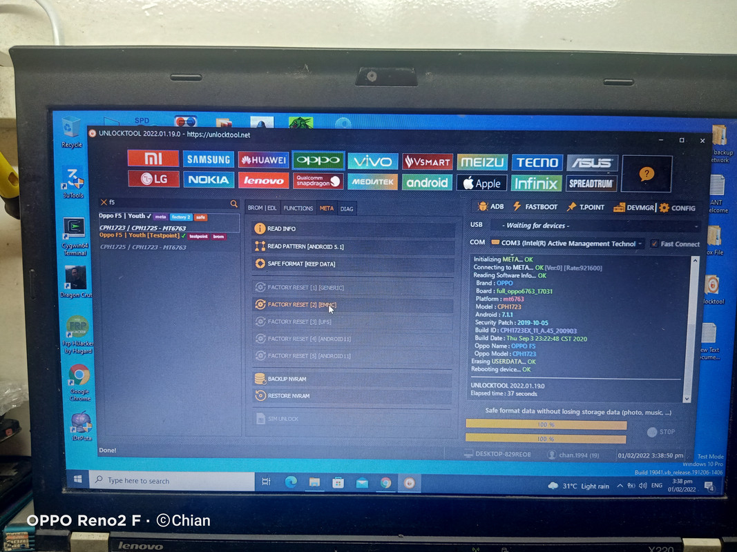

Turn off unit and open unlocktool. Select brand 'OPPO' search 'F5' and click 'FACTORY RESET [2] [EMMC] now hold volume up and down at isaksak ang usb cable then wait until it done

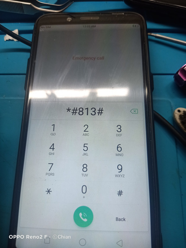

Para naman sa frp dial *#813#

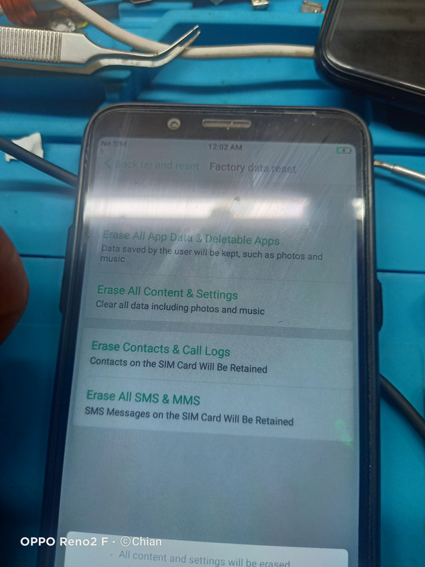

Now go to settings and make factory reset 'Erase All Content & Settings'

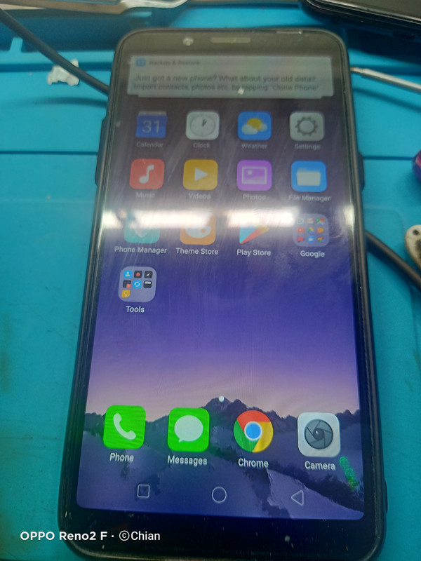

At heto naman po ang proof ko.
