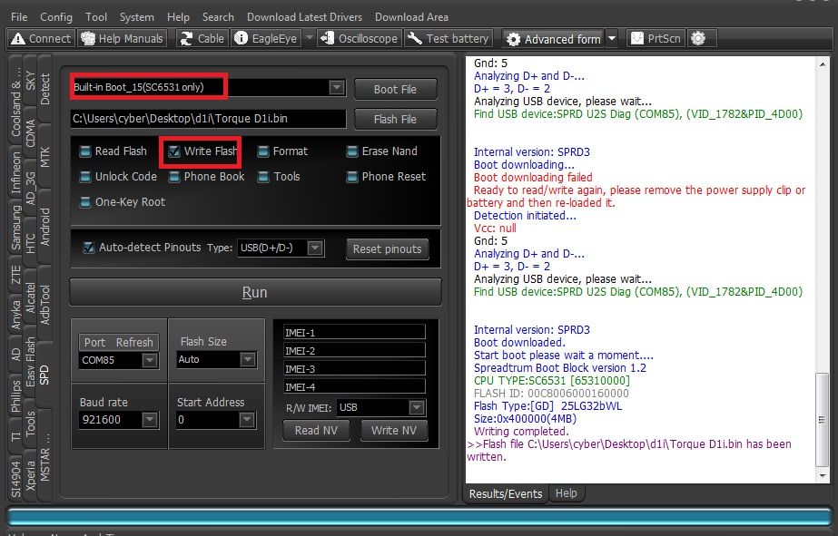

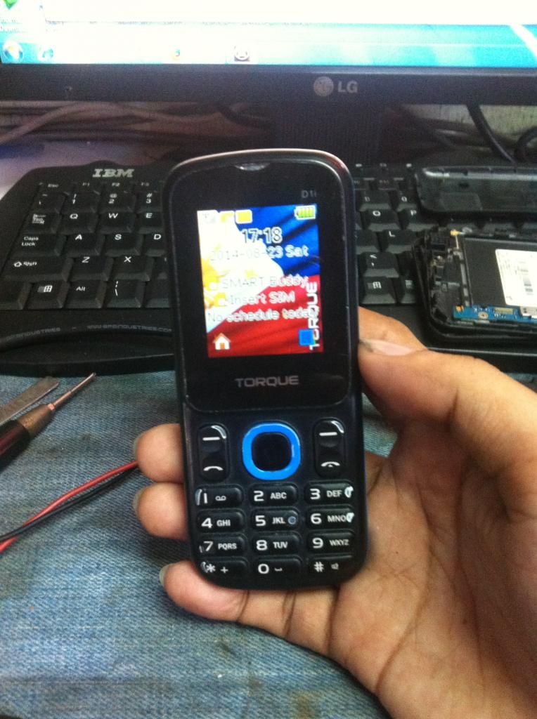

Problem
Auto off When inserting sim card
Action Taken
Flash w/ Tested Firmware
Procedure
Use Volcano box
SPD tab
Select Boot SC6531
select Firmware Check Write Firmware
Screen shots
