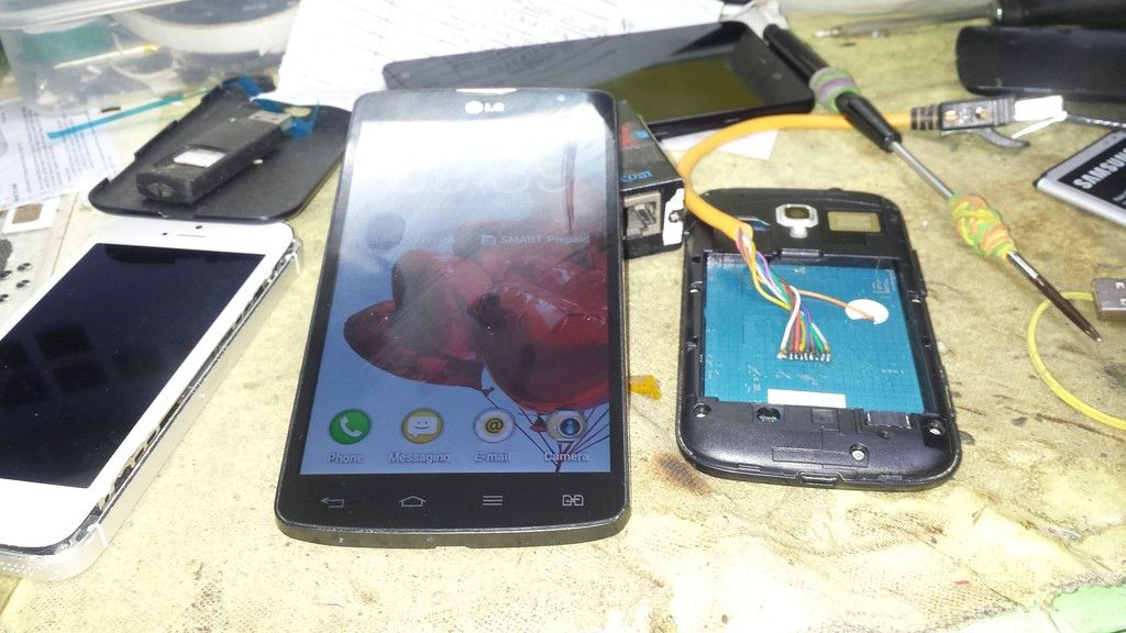

DemiGod Crash Handler: DBI Err Fatal repair...
no emergency mode done(walang emergency or download'diretsu lang cya sa ganyan error)
1st action; JTAG
Operating Mode: EasyRepair Mode
Selected device model: LG D380 USB
Connecting. Please wait...
MI: Loading Medusa Device Server V2.USB.
MI: Connecting to Device Server.
MI: Initializing.
MI: Flash ID = 0xE0909201.
Interface : USB
CPU : Qualcomm MSM8610
Storage Device: Hynix eMMC H4G1d
Device ID : 00909201
Block size : 512 bytes
Blocks : 7634944
Storage size : 3728 Mb
Opening "C:\Users\hf\Desktop\LG_D380_Repair.mf\LG_D380_Repair.mf" file...
Writing ABOOT section. Please wait... Done
Writing BOOT section. Please wait... Done
Disconnected
2ND ACTION;FLASH BY OCTOPUS
Welcome to Octoplus/Octopus Box LG Software version 2.3.2
Checking data...OK
Platform: LG Qualcomm
Selected port: COM4
Selected model: D380
Reading info...
Could not detect mode!
Performed by 2.3.2 software version.
Checking data...OK
Selected port: COM4
Reading info...
Checking data...OK
Selected port: COM22
Reading info...
Mode: Emergency
Initializing flash...OK
SW version: LGD380AT-00-V10a-ESA-XX-MAY-07-2014+0
LAF Version: 1.0
Product ID: CT68S140525001054
IMEI: 354106-06-166925-2
Target operator: GLOBAL
Hardware: rev_11
Opening "D38010d_00_2.oct"...OK
Setting options...OK
Reading partitions...OK
Formating USERDATA...OK
Writing PrimaryGPT...OK
Writing modem...OK
Writing sbl1...OK
Writing rpm...OK
Writing tz...OK
Writing sdi...OK
Writing aboot...OK
Writing rpmb...OK
Writing tzb...OK
Writing abootb...OK
Writing persist...OK
Writing laf...OK
Writing boot...OK
Writing recovery...OK
Writing factory...OK
Writing sbl1b...OK
Writing cust...OK
Writing system...OK
Writing BackupGPT...OK
Formating RCT...OK
Formating MPT...OK
Finalizing...OK
Writing firmware done!
