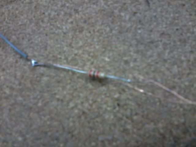

2koms resistor

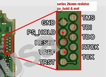

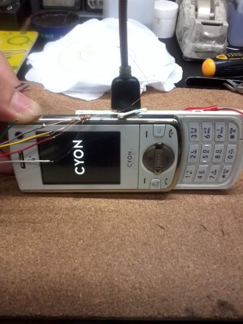

Connect jtag wire on phone
Put 2kohms resistor on ps_hold & vref

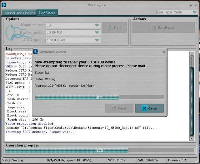

Press pwr on to phone set power supply to 2.9v insert usb cable,or simple just click easy repair then follow procedure

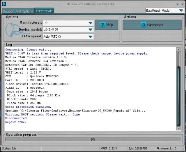

Jtag done already sucessful its shows like this:

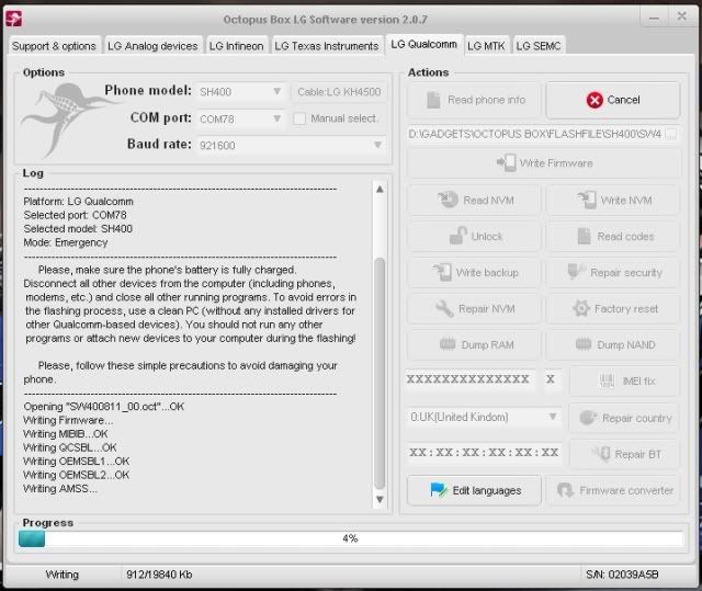

Remove solder wire close the unit flash the unit with orig firmware thru octopus box support
after flashing all done must proceed to repair nvm then unlock
Unit already done

2koms resistor
Unit already done
