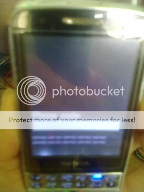

sabi ng customer di daw maopen ang phone nya.
yun pala may password, nakalimutan raw nya.
ito ang pic ng unit:

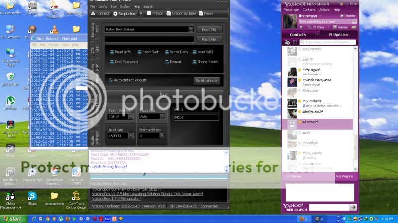

kaya ginawa ko format sa aking volcano.
PROCEDURE:
open volcano
click Mstar
click readflash and then click RUN(back up ko muna baka sakali.)
logs ng back up ko.
PROCEDURE:
open volcano
click Mstar
logs ng back up ko.
PROCEDURE:
open volcano
click Mstar
logs ng back up ko.
and then format ko na sya
ito ang logs.

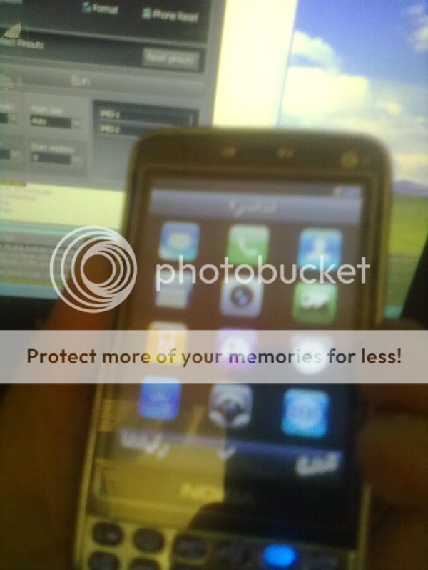

my finish product::x

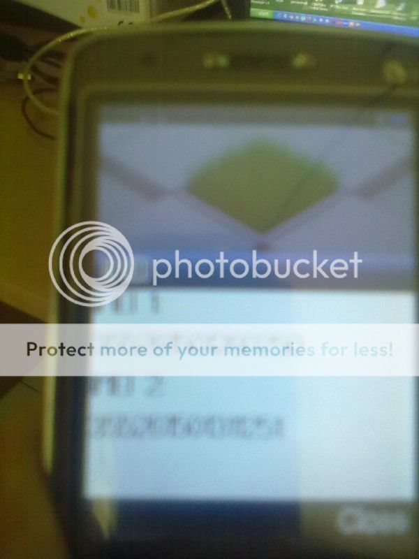

at ito buo pa rin imei nya
sensya na malabo yung pic...
ito ang logs.
2012-12-04 1:55:41 PM >>Detection initiated...
2012-12-04 1:55:43 PM >>Vcc: 12
2012-12-04 1:55:43 PM >>Gnd: 6 10
2012-12-04 1:55:43 PM >>Analyzing D+ and D-...
2012-12-04 1:55:48 PM >>D+ = 3, D- = 1
2012-12-04 1:55:48 PM >>Detection D+/D- with 3.86 seconds!
2012-12-04 1:55:48 PM >>Analyzing USB device, please wait...
2012-12-04 1:56:02 PM >>Found [MSTAR]USB device:GCREADER USB Device,(VID_1B20&PID_0300)
2012-12-04 1:56:02 PM >>Setting...
2012-12-04 1:56:05 PM >>Find USB device:GCREADER USB Device, (VID_1B20&PID_0300)
2012-12-04 1:56:05 PM >>Pinouts setting complete!
2012-12-04 1:56:05 PM >>Connecting to phone...
1290492012 1:56:05 PM >>Connecting to phone...
2012-12-04 1:56:05 PM >>Connection success!
1290492012 1:56:05 PM >>Connection success!
2012-12-04 1:56:06 PM >>Boot downloading...
1290492012 1:56:06 PM >>Boot downloading...
2012-12-04 1:56:06 PM >>Flash Type: SPANSION_S71WS128P
1290492012 1:56:06 PM >>Flash Type: SPANSION_S71WS128P
2012-12-04 1:56:07 PM >>Flash ID: 0001440000000000
1290492012 1:56:07 PM >>Flash ID: 0001440000000000
2012-12-04 1:56:07 PM >>Flash Size: 01000000h
1290492012 1:56:07 PM >>Flash Size: 01000000h
2012-12-04 1:56:08 PM >>Flash Erasing...
1290492012 1:56:08 PM >>Flash Erasing...finish
