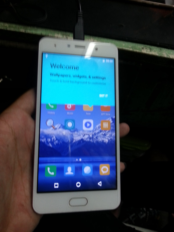

SHARE KOLANG SA INYO MGA LODI DAGDAG KAALAMAN NATANGGAP KO DING DING

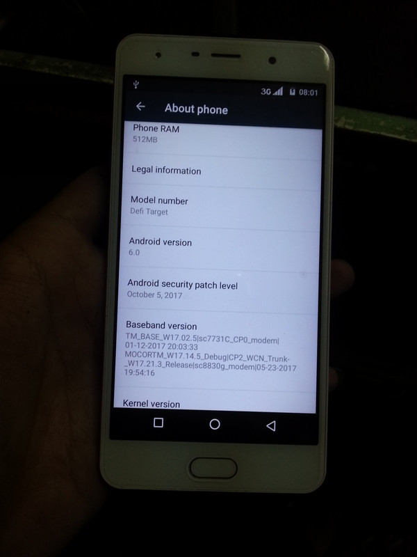

MODEL DEFI TARGET LOADING ANDROID LANG SIYA AUTO RESTART :))

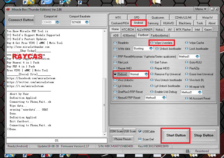

TRY KO MUNA FORMAT SA CM2 SPD 6.0 OK OK NAMAN SA PAG FORMART PERO SAME PARIN
TRY KO MAG DOWNLOAD NG FW PERO ERROR UBOOT ERROR TRY KOSA MIRACLE FORMAT PERO
BOOTLOADER ERROR DIN ANG NAICP KO TRY KO SA FAST BOOT KC MINSAN YAN ANG GINA GAWA KO PERO DONE HEHE BY MIRACLE ANDROID FAST BOOT TNX PERA NA MAY PANG BILI NA NG LOTTO :))
STEP 1. PRESS POWER 2 TO 3 SECOND SABAY PRESS ANG VOL DOWN THEN AFTER LUMAS ANG LOGO
BITAWAN MONA ANG POWER BOTTON STAY LANG ANG VOL DOWN HINTAIN LUMABAS ANG RECVRY NYA
SELECT BOOTLOADER PARA MAKA FAST BOOT :)):))
