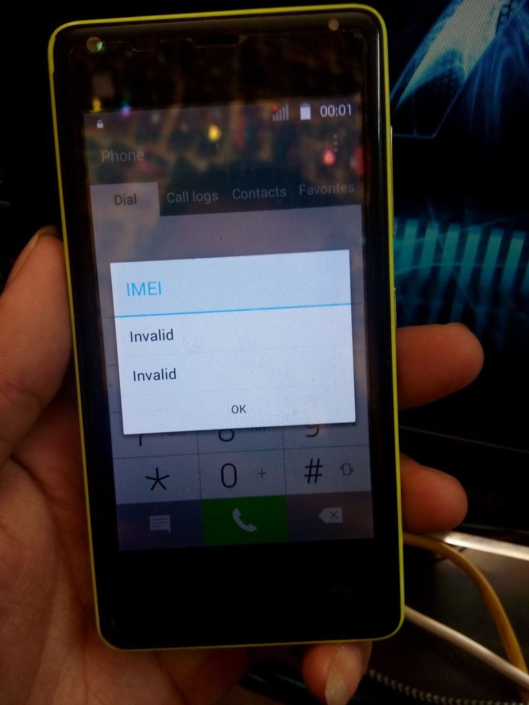

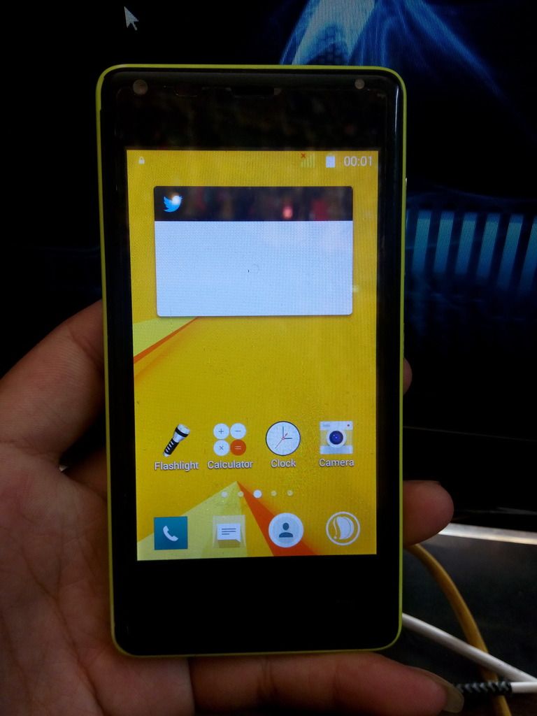

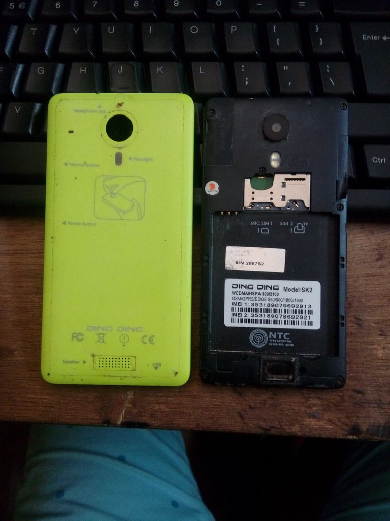

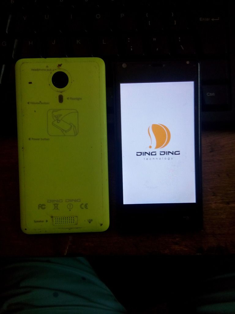

SHARE KOLANG PO MGA KA ANT BAKA MAKATULONG DITO SA TAHANAN
STORY NG CELLPHONE NI TUMER AUTO ON WIFI AUTO DOWNLOAD YON HINDI NAG
TAGAL NAG HANG NA SA LOGO
HR KO PERO HINDI NIYA NAKAYA

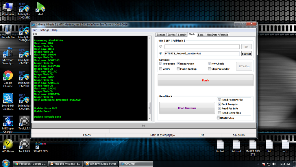

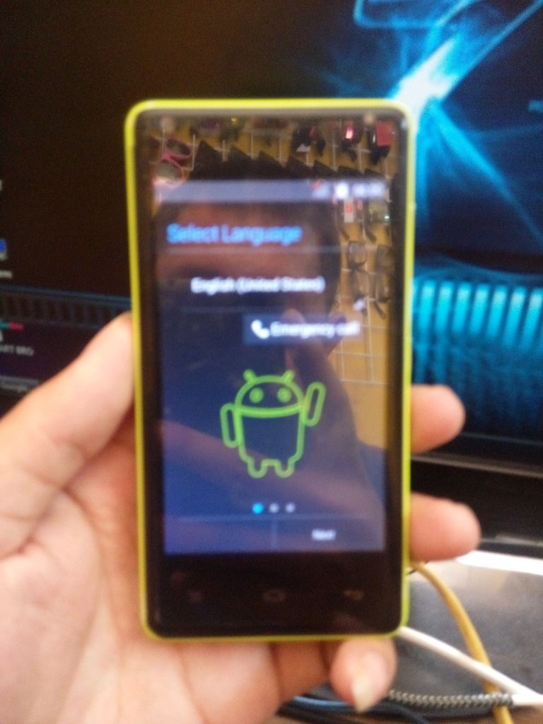

NAG FLASHING NALANG AKO AGAD SA TESTED NA FIRMWARE KO DONE
PROBLEMA AFTER DONE FLASHING INVALID IMEI
NAG WRITE IMEI KO SA CM2 NA GINAMIT KO DONE
ITO ANG FIRWARE MAY PASS PO ITO

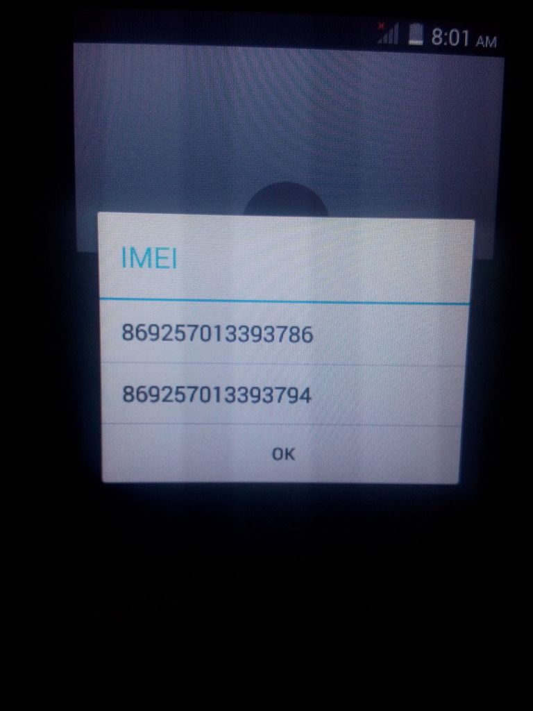

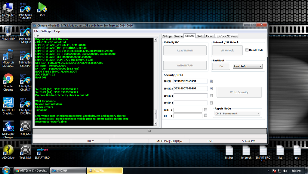

Maraming Salamat sa FILES boss RhayCas.. Tested po..
Invalid IMEI nga po..
Ginamitan ko ng tricks Credits to SMOD RANNIS para sa tools na ginamit ko..
Tpos ito na po sya after Restart CP.
THANKS PO BOSS RHAYCAS
