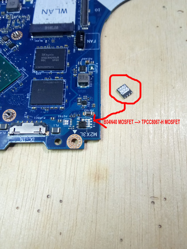

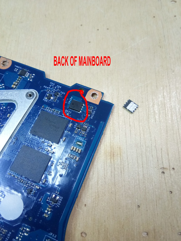

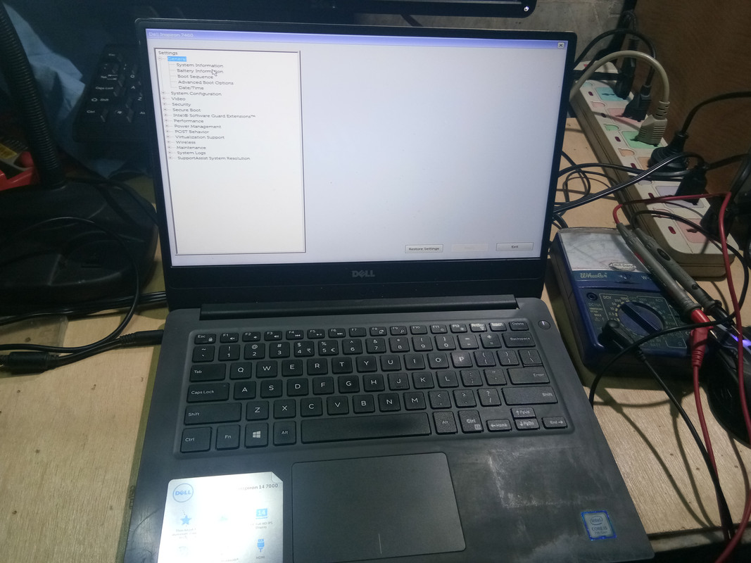

Done & Success!!! Dell Inspiron 14 7000 Core i5 7Gen No Power.....
Cause of No Power:
1. Shorted Mosfet B04N03 N-CH subtitute part TPCC8067-H N-CH kung wala kang maipalit
2. Capacitor
Troubleshoot Technique: Power Section & Charging Section
1. Check Positive & Negative Resistance Pin in Mainboard (kung may shorted)
2. after mapalitan check po natin uli ang resistance V- & V+ pin kung ok na proceed step 3

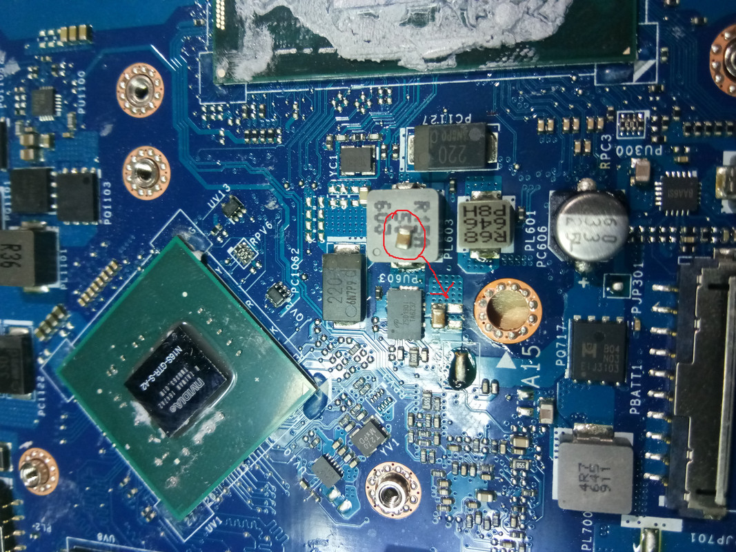

3. check shorted caps yan po ang reason bakit nasira ang mosfet mga lima o higit pa ang makikita mong akala mo shorted pero isa lang po yan laging naka parallel medium size po yung shorted caps isa lang dun po ang sira kaya dito tanggal kabit po tayo mga boss.
swerte mo lang kung natanggal mo agad yung shorted he he he
