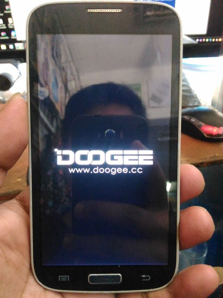

Problem : naka hang po sa logo

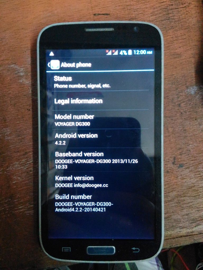

info:
Brand : DOOGEE
ProdName : ratech72_wet_rlk_jb3
ProdModel : VOYAGER DG300
Device : ratech72_wet_rlk_jb3
AndroidVer: 4.2.2
MTKxCPU : MT6572
MTKxPRJ : DOOGEE-VOYAGER-DG300-Android4.2.2-20140421

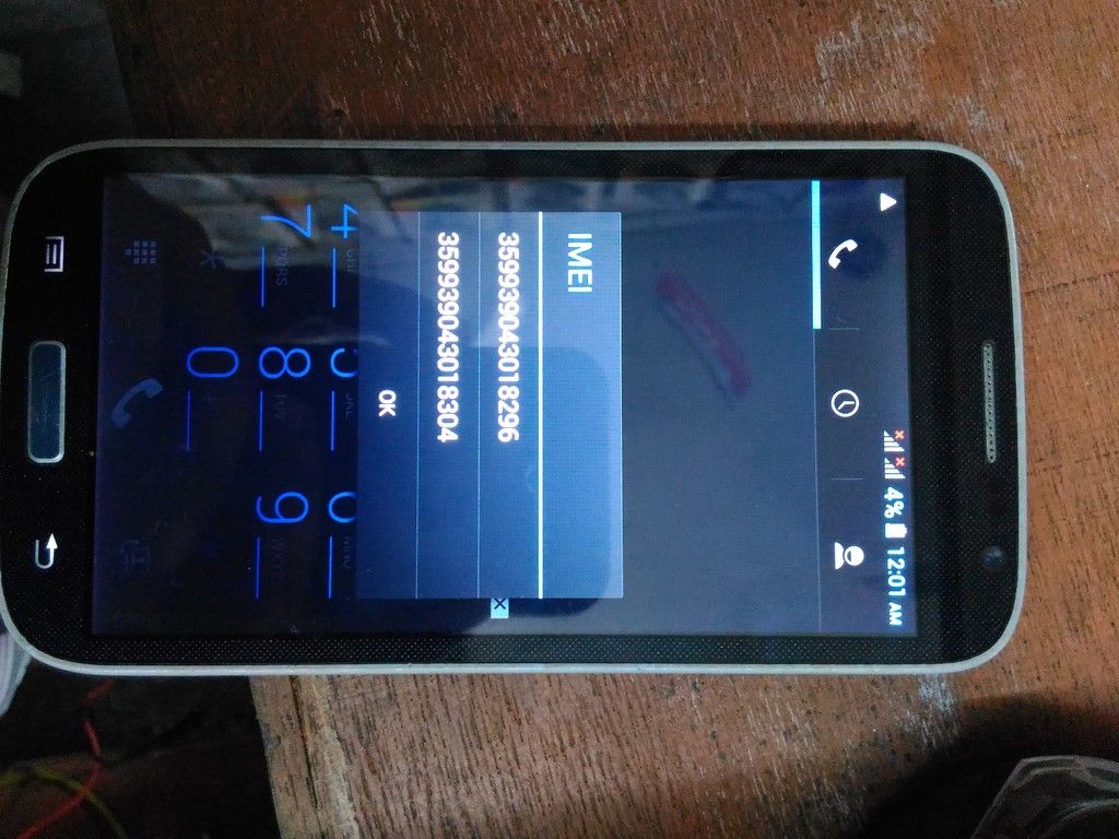

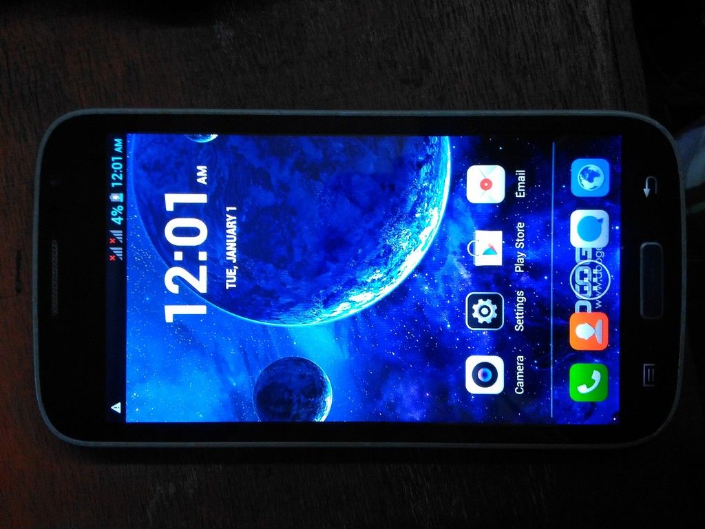

at eto na po ok na po:
