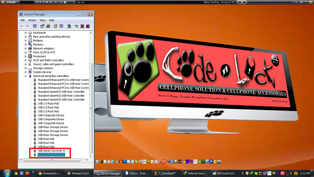

On your device manager

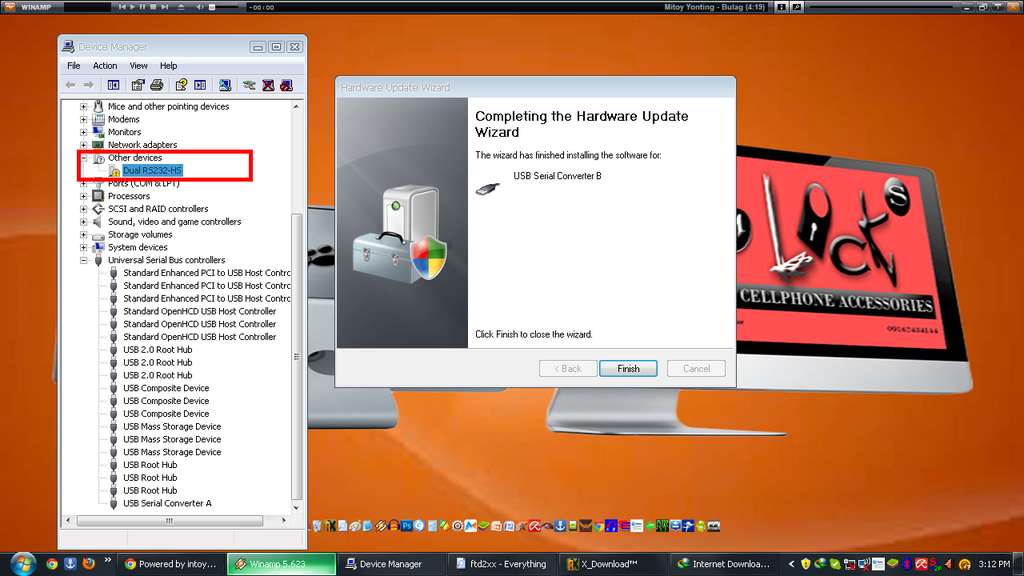

Right click dual rs232-hs
Update your driver
Browse the drivers on your desktop..wait until
the drivers like this in images below...

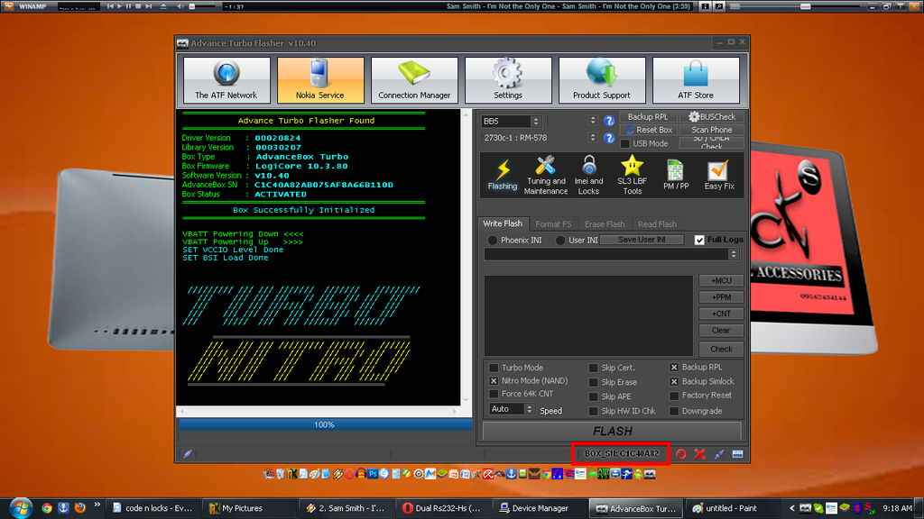

After Update Eeprom Open ATF Exe (Look Here)
Aft Said Need To Update New Atf Driver!!!!
Go To Device Manager Then Update Ur Atf Driver
C:\AdvanceBox Turbo Flasher\Driver\ATF_NEW_DRIVERS
After Make Update Driver We Must Restart Ur Pc.
Now Box Ready To Use And Serial Number Restored
