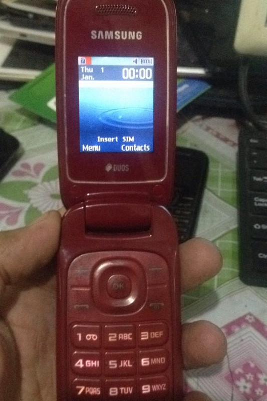

E1272 input password done cm2 spd

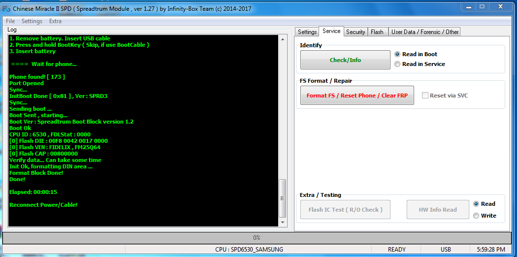

procedure

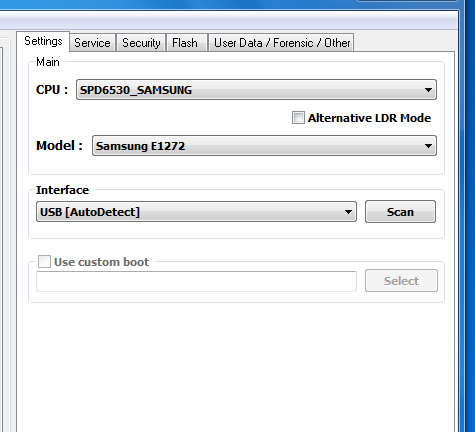

open cm2
choose cpu type and model
then go to servive tab hit format
hold center or ok button
insert usb cable
done done done
