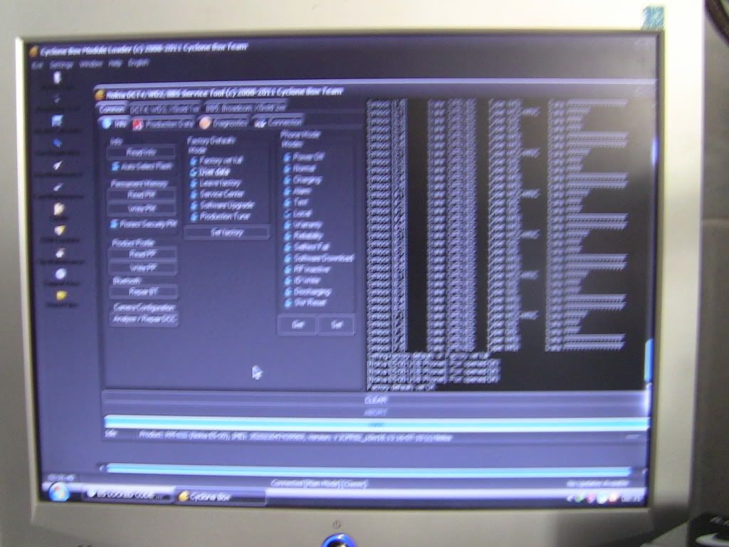

E5 Security Code by cyclone done via usb...[Reference]
open cyclone box (use usb cable 5130)
goto coonection (tick usb)
select bb5 tab
connect phone (w/ battery)
tick check flashing bus
press shortly power button
read info
Factory set full
Click here to view the original image of 769x577px.
Handling device: [Cyclone Team], [Cyclone Box], [Platform: Classic]

XGold/Blackberry Service Running, Credits Left: 100
Avaiable Physical Memory: 1.318GB
Avaiable Virtual Memory: 1.493GB
Avaiable Pagefile: 3.329GB
Initializing FBUS...
All initialized - Ready to work
Booting CMT...
[Nokia USB Flashing Generic]: Port opened OK!
Old ROM Detected
CMT_SYSTEM_ASIC_ID: 000000030000022600010007600C192102031104
CMT_EM_ASIC_ID: 00000C35
CMT_EM_ASIC_ID: 00000C30
CMT_PUBLIC_ID: 27300205ADA403441290F6D237E8351FD3DCEC9C
CMT_ASIC_MODE_ID: 00
CMT_ROOT_KEY_HASH: 916F75217F32081248B15C38DFC8E81B
CMT_BOOT_ROM_CRC: E693EF0D
CMT_SECURE_ROM_CRC: AC22615B
CMT Ready!
Searching for BootCode: DualLine 32Bit
RAPUv11_2nd.fg, Type: 2nd Boot Loader, Rev: 768.11.24.0, Algo: BB5
Using NEW BB5 FLASHING PROTOCOL
Waiting for USB Boot ROM Answer...
ROM Ret: 0xFFFD125D
ROM CMT dwAddr: 0x10004FF0
ROM CMT dwLength: 0x00627837
Seems ROM Initialized OK!
Transmission Mode Requested: Control USB, Accepted: Control USB
FlashChip[0,CMT]: 0x0000000000000000, Unknown, RAM
FlashChip[0,CMT]: 0xFFFF000000000000, Unknown, MMC
FlashChip[0,CMT]: 0x0000000000000000, Unknown, NOR
FlashChip[1,CMT]: 0x0000000100000000, Unknown, NOR
FlashChip[0,CMT]: 0x00EC005000000031, Samsung, ONENAND
Requested Algorithm: XSR 1.6 (CMT)
FlashChip 0x00EC0050 (Samsung), Size: 512MBytes, VPP: Not Supported
RAPUv11_XSR17_alg.fg, Type: Algorithm, Rev: 768.11.24.0, Algo: XSR 1.6
Initializing TurboCache...
TurboCache Loaded!
Writing CMT PASUBTOC Certificate...
Writing CMT ALG Certificate...
CMT Algorithm Ready!
Transmission Mode Requested: Bulk USB, Accepted: Bulk USB
Box TX2 Data Pin set to: Service Pin 3
Waiting for FUR Client become avaiable...
FUR Avaiable!
Adding FUR Client (CMT, State: Ready)...
CMT FUR Ready!
Overriding VPP Setting, USB can't use VPP
Box VPP disabled
Internal CMT Phone VPP Enabled
PAPUBKEYS Hash for CMT: CCD9F80559BA50D9B3E274F9E7120BE1EE4EEA7C
APE Boot skipped on user request
Restarting MCU...
[Nokia E5-00 USB Phonet]: Port opened OK!
MCU Version V ICPR82_10w18.13
MCU Date 16-07-10
Product RM-632 (Nokia E5-00)
Manufacturer (c) Nokia
IMEI 35202304
Mastercode 307533657
IMEI Spare 3A25200374349906
IMEI SV 3325200374349906F7000000
PSN 0705A30AA
Product Code 0595754
Module Code 0204475
Basic Product Code 0590165
PSD 0000000000000000
LPSN 0
WLAN MAC 18145643DA4C
APE SW 042.007
APE Variant 042.007042.007.25.01042.007.C00.01
APE Test 0.025
APE HW 256
APE ADSP 256
RETU 35
TAHVO 00
AHNE 11
HW 3001
RFIC |Vapaus_5.1 | Mikki_1.1
DSP ICPR82_10w18.6
Simlock Server SIMLOCK SERVER
Simlock Key 2440700000000000
Simlock Profile 0000000000000000
Simlock Key Cnt 0
Simlock FBUS Cnt 0
Simlock [1,1] State: OPENED Type: MCC-MNC Data: FFFFFF
Simlock [1,2] State: OPENED Type: GID Data: FFFF
Simlock [1,3] State: OPENED Type: GID Data: FFFF
Simlock [1,4] State: OPENED Type: IMSI Data: FFFFFFFFFFFFFFFF
Simlock [1,5] State: OPENED Type: IMSI Data: FFFFFFFFFFFFFFFF
Simlock [2,1] State: OPENED Type: MCC-MNC Data: FFFFFF
Simlock [2,2] State: OPENED Type: GID Data: FFFF
Simlock [2,3] State: OPENED Type: GID Data: FFFF
Simlock [2,4] State: OPENED Type: IMSI Data: FFFFFFFFFFFFFFFF
Simlock [2,5] State: OPENED Type: IMSI Data: FFFFFFFFFFFFFFFF
Simlock [3,1] State: OPENED Type: MCC-MNC Data: FFFFFF
Simlock [3,2] State: OPENED Type: GID Data: FFFF
Simlock [3,3] State: OPENED Type: GID Data: FFFF
Simlock [3,4] State: OPENED Type: IMSI Data: FFFFFFFFFFFFFFFF
Simlock [3,5] State: OPENED Type: IMSI Data: FFFFFFFFFFFFFFFF
Simlock [4,1] State: OPENED Type: MCC-MNC Data: FFFFFF
Simlock [4,2] State: OPENED Type: GID Data: FFFF
Simlock [4,3] State: OPENED Type: GID Data: FFFF
Simlock [4,4] State: OPENED Type: IMSI Data: FFFFFFFFFFFFFFFF
Simlock [4,5] State: OPENED Type: IMSI Data: FFFFFFFFFFFFFFFF
Simlock [5,1] State: OPENED Type: MCC-MNC Data: FFFFFF
Simlock [5,2] State: OPENED Type: GID Data: FFFF
Simlock [5,3] State: OPENED Type: GID Data: FFFF
Simlock [5,4] State: OPENED Type: IMSI Data: FFFFFFFFFFFFFFFF
Simlock [5,5] State: OPENED Type: IMSI Data: FFFFFFFFFFFFFFFF
Simlock [6,1] State: OPENED Type: MCC-MNC Data: FFFFFF
Simlock [6,2] State: OPENED Type: GID Data: FFFF
Simlock [6,3] State: OPENED Type: GID Data: FFFF
Simlock [6,4] State: OPENED Type: IMSI Data: FFFFFFFFFFFFFFFF
Simlock [6,5] State: OPENED Type: IMSI Data: FFFFFFFFFFFFFFFF
Simlock [7,1] State: OPENED Type: MCC-MNC Data: FFFFFF
Simlock [7,2] State: OPENED Type: GID Data: FFFF
Simlock [7,3] State: OPENED Type: GID Data: FFFF
Simlock [7,4] State: OPENED Type: IMSI Data: FFFFFFFFFFFFFFFF
Simlock [7,5] State: OPENED Type: IMSI Data: FFFFFFFFFFFFFFFF
Failed to Read Security Code -> No any security code found
MCU Date 16-07-10
IMEI 352023047
PSN 0705A30AA
Module Code 0204475
LPSN 0
APE SW 042.007
APE Test 0.025
APE HW 256
APE ADSP 256
RETU 35
TAHVO 00
AHNE 11
HW 3001
DSP ICPR82_10w18.6
Simlock Key Cnt 0
Simlock FBUS Cnt 0
Setting factory defaults of: Factory set full
Factory defaults set OK
