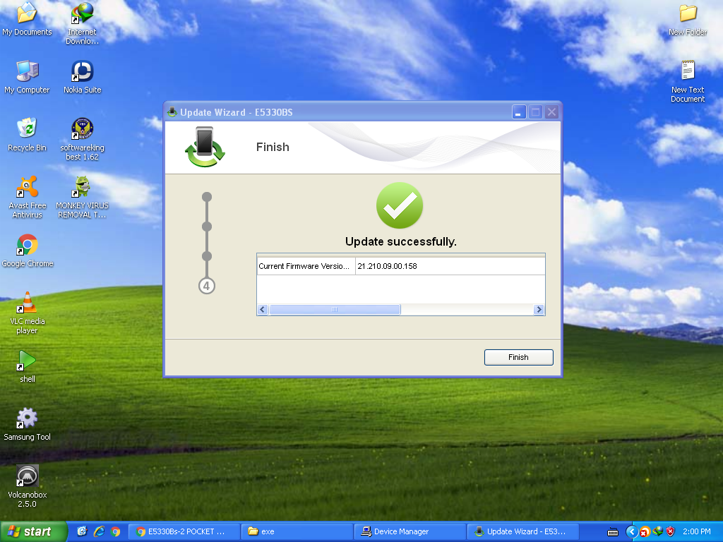

share ko lang po baka sakaling kailangan nyo rin E5330BS-2 blinking only
Procedure
* to detect in pc press and hold reset button and power button sabay po pindutin
* install drivers if needed
* press start button and wait hanggang matapos
* and your done update successfully
tools to be needed
http://www.mediafire.com/download/vpkjdkbcd683rkv/Drivers_v.5.01.06.00.rar
drivers po yan
ito naman ang firmware
http://consumer.huawei.com/ph/support/downloads/index.htm?keyword=E5330Bs

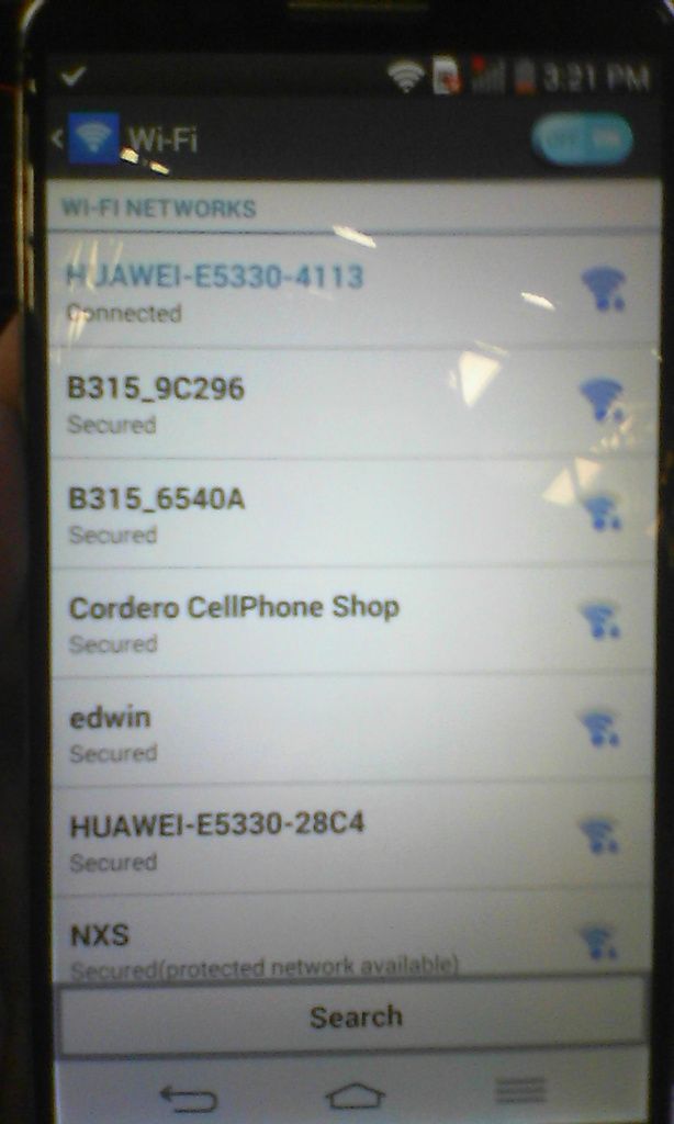

connected na done....
