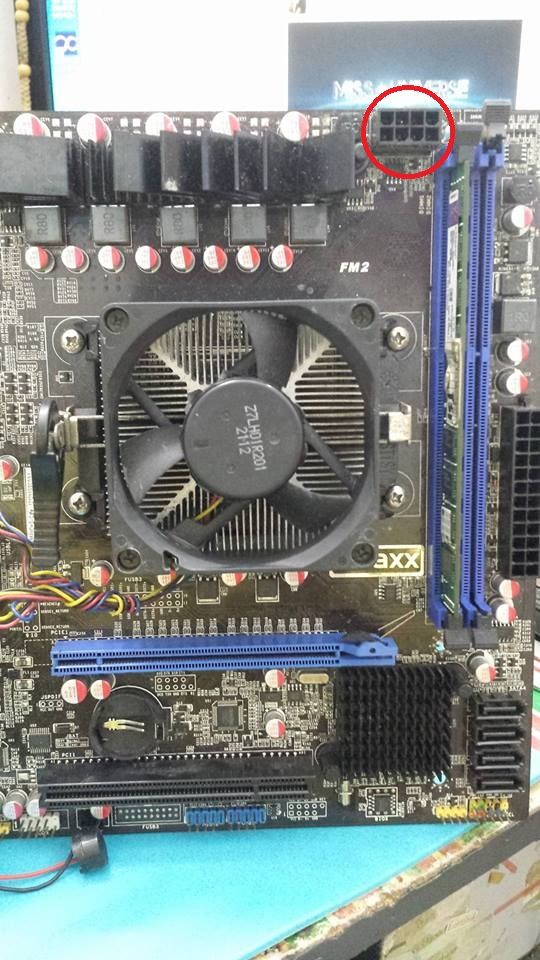

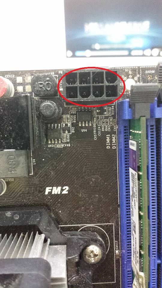

nioty0006 Registered Joined Jul 6, 2014 Messages 20 Jan 30, 2017 #1 help mga master,. emaxx motherboard, kapag my suply po itong my bilog ayaw po mag on, bka my naka encounter na sa inyo mga amo,.. gamit ko sa shop, sayang kasi bigla n lng bumigay, bka matulungan nyo ako mga amo,.. ((
S sherwin Expired Account Joined Jul 21, 2015 Messages 233 Jan 30, 2017 #2 palit ka power supply idol pag ayaw try mu ung 4 pins lng ikabit mu
nioty0006 Registered Joined Jul 6, 2014 Messages 20 Jan 30, 2017 #3 negative sir 3 power suplly n gamit ko puro same,. pag nkatangal yung 4pins nag oon sya kaso walang display,..
Berdugo Registered Joined Oct 30, 2014 Messages 1,127 Jan 30, 2017 #4 tester katapat nyan sir... ung baba n pin ang negative (pag mali ung taas lahat ang negative lols) +probe sa GND -Probe sa vcc tingnan mo kung shorted... 12v supply yan kindly check kung kumpleto ang supply ng PSU mo,
Berdugo Registered Joined Oct 30, 2014 Messages 1,127 Jan 30, 2017 #6 6pins?... single rail yun sir so 4+, 4-, 12v supply in in pralel pra malakas ang amperahe pumasok...
