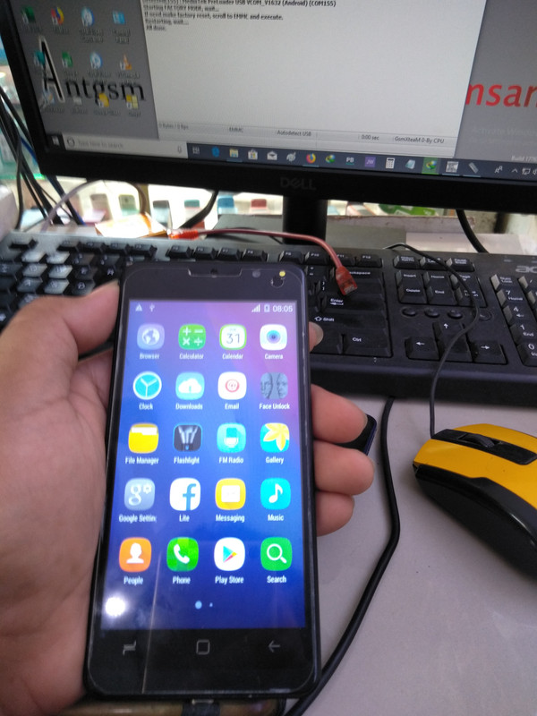

sabi ni tumer na subrhan sa apps may naka lagay sa taas na internal storage is running out
Action taken :
Manual hard reset same pa rin
format using cm2 error try read emmc first

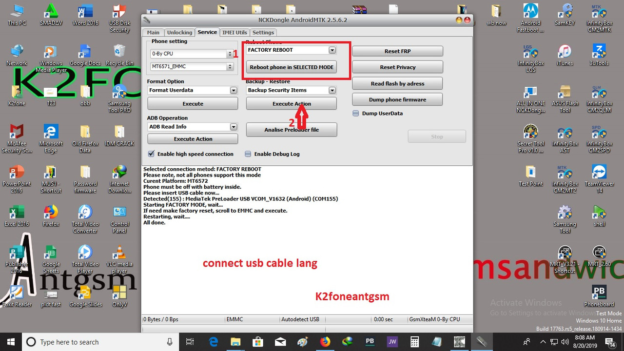

last action taken
open nck crack marami namn naka kalat niyn sa ating tahanan
goto tab service
select factory reboot
Exsecute
conect usb cable wit out any boot key
may lalabas
select ................alam na this hehe
