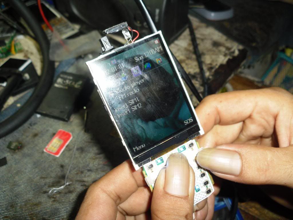

SHARE KO LANG,, CHINA PHONE F9 WHITE SCREEN,,

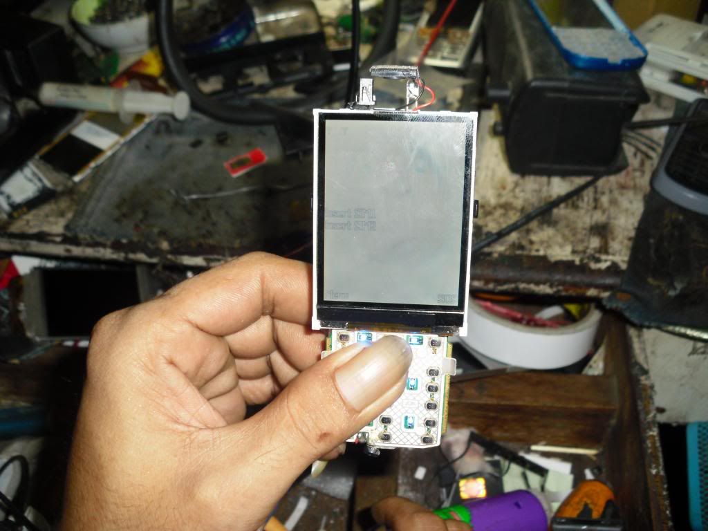

HISTORY,, MINSAN OK MINSAN WHITE SCREEN SABI N CS.
ACTION TAKEN***** CHECK KO MABUTI ANG UNIT MAY TAMA TALAGA ANG LCD.
ETO CYA DATI.
SABI KO KAY CS,, LCD PO MAAM ANG SIRA..
PAG REPLACEMENT PO 400.
SABI NI CS,, DKO KYA,, SABI KO TRY NATIN E REPAIR
PAG NAKUHA SA REPAIR 300 NA LANG,, PUMAYAG NAMAN SI CS.

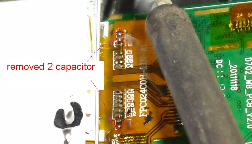

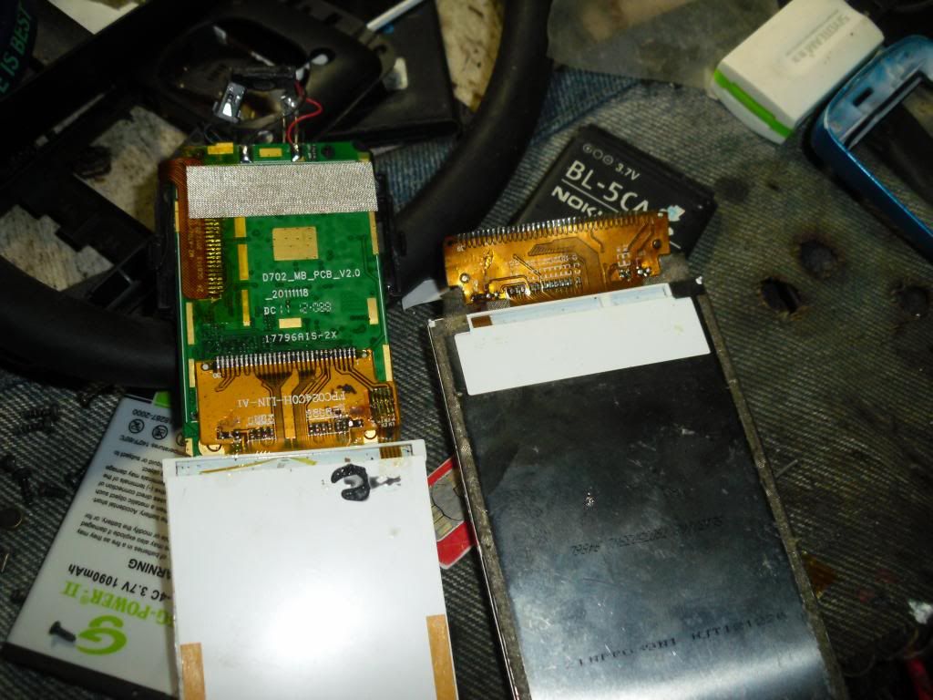

STEP 1---TRY KO PALITAN NG 2 CAPACITOR GALIN DIN SA SIRANG LCD
ILANG BESES NA RIN NAKAINCOUNTER NITO,, NAGKAKADISPLAY ANG UNIT
BUT ETO WA EFFECT.
STEP 2 --- NAISIP KUNG REMOVED NA LANG ANG 2 CAPACITOR,,

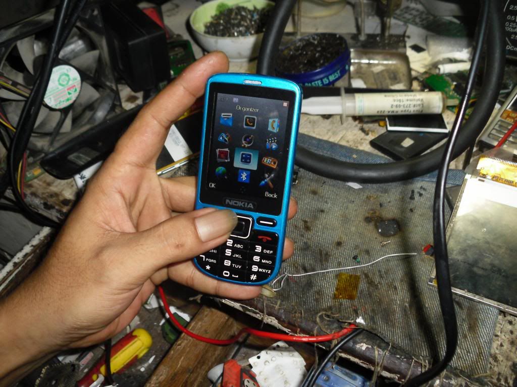

ABA NAGULAT AKO ANG LINAW NG DISPLAY.
DONE
