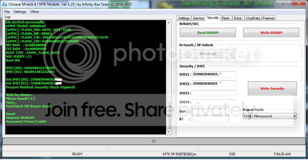

hi to all share ko lang ito
firefly mobile gt100s no power ok namn ang batt. nya check info ko sa infinity
preloader erase hindi sya alive,check ko hardware ok nmn wla rin water damage
kya try ko eflash ito yung firmware at flasher
kung wla kayong account regester lang
http://www.needrom.com/download/firefly-gt100s/
pagkatapos e flash invallid imei write mo sa CM2
Operation : Repair Security [ v1.25 ]
Wait for phone...
Phone found! [ 4 ]
Sync...
Inital regs read done
Boot Info :
BB_CPU_ID : 6582
BB_CPU_HW : CB00
BB_CPU_SW : 8A00
BB_CPU_SB : 0001
BB_CPU_NM : [MediaTek] MT6582_S00
Processing BROM stage
SecCfgVal : 0x00000000
BromVersion : 0xFF
BLVersion : 0x01
Preloader Status : Alive
Processing DA stage
DA Select done , sending
NAND_ID : 00000000000000000000000000000000
eMMC_ID : 700100563130303038062C487B5C4239
DA Stat : v4.2 on BBID : 0x87
DA Sent. Configure setting now ...
DA started successuflly
eMMC FlashIC initialized
[eMMC] : FLASH_VEN : 0070 , OEM : 0100
[eMMC] : FLASH_INF : 80001
[eMMC] : FLASH_CID : 700100563130303038062C487B5C4239
[eMMC] : FLASH_LEN : 0x00000001C3000000
INT RAM : 0x00020000
EXT RAM : 0x40000000
BOOT TYPE : EMMC_FLASH_BOOT
SOC VERIFY : C1
Boot Ok!
IMEI [00] : 426690032378584
IMEI [01] : 066891483232601
Set IMEI [00] : 359083040503***
Set IMEI [01] : 359083040503***
Prepare finished. Security check required!
Wait for phone...
Phone found! [ 4 ]
Sync...
PostCheck Ok! Repair done!
Done!
Elapsed: 00:00:49
Reconnect Power/Cable!
