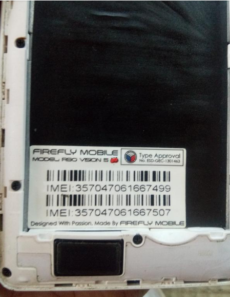

Model? Firefly mobile R90 Vision 5 version 4.4.2
Pwede sa infected virus pwede din sa Hang logo issue.
