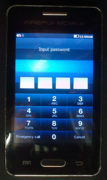

PROBLEM;
Screen Lock

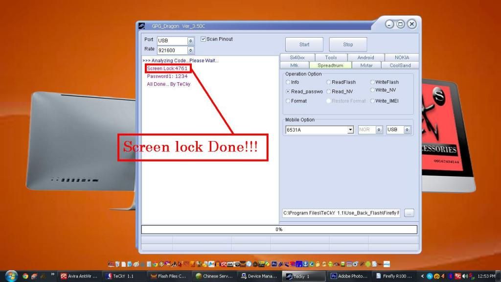

Open Si Dragon Crack
Click Spreadtrum
Click Read Flash

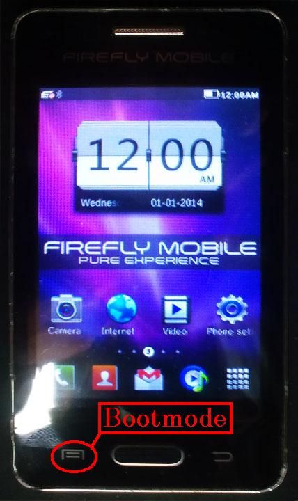

Click Mobile Option And Set To 6531a
Open C:\Temp_File.bin And Create The File Name Of Your Phone Model
Click Start And Insert Micro Usb To Your Phone And Press Boot Mode..
After Back Up Finish
Click Read Password And Click Start And Your Done!!!
DONE!!!
