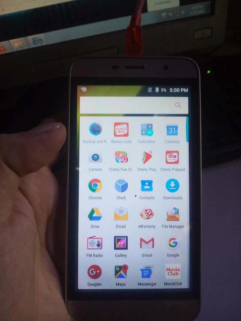

gud day share ko lang CHERRY MOBILE FLARE J1 PLUS
naka FRP LOCK done by cm2

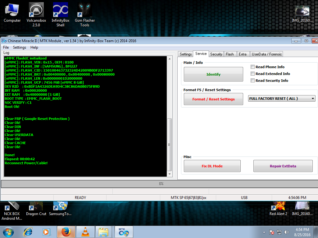

FORMAT RESET ALL SETTING SA CM2 DONE
Created by Infinity-Box (c) Chinese Miracle II (c) 2016
Device Brand : Cherry Mobile
Device Model : FLARE_J1_PLUS
Device CPU : MT6580
Device IntName : FLARE_J1_PLUS
Device Version : 6.0
Device Compile : 4/26/2016 10:24:36 AM
Device Project : alps-mp-m0.mp1-V2.34_vz6580.weg.i.m
Device ExtInfo : FLARE J1 PLUS
