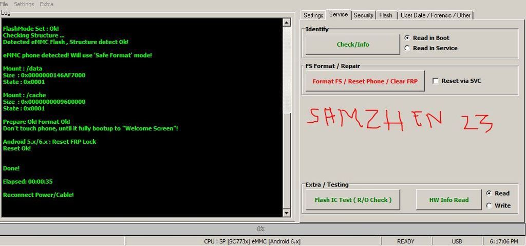

Flare j2 dtv FRP done kay cm2
ayaw kay fastboot kay cm2 walang kawala
procedure
open cm2 spd
choose boot sc773x emmc android 6.x
then go to service tab
choose format fs/reset phone/CLEAR FRP

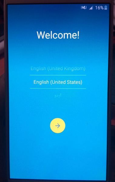

then auto reboot n sya
then may skip na frp nia enjoy
thanks for viewing for refference
