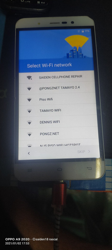

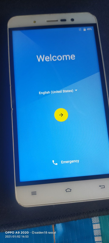

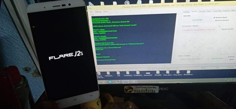

PROCEDURE
OPIN CM2SPD
CLICK/SETTING
CLICK/CPU THEN
CLICK/SP[SC983[EMMC/4,5,0
CLICK/SERVICE
CLICK/FORMAT FS/RESET PHONE LEAR FRP
HOLD VOLUME UP
THEN CONNECT USB CABLE
WAITING DONE
FINISH PRODUCT
