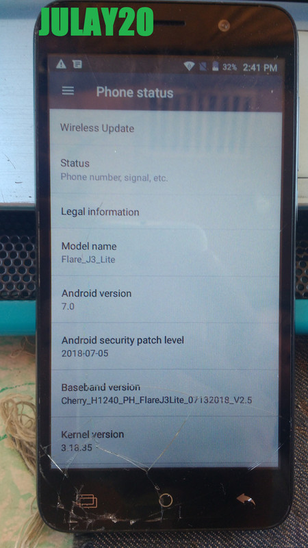

Flare j3 lite Done sa NCK Crack
History:
na reset ng tumer di na alam yung google account nya
kaya patangal daw nya ito

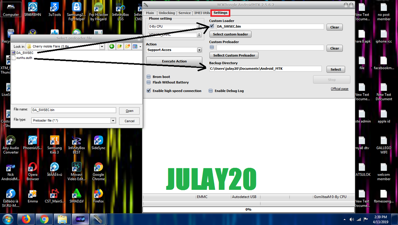

open nck crack
go to settings
custom loader
select custom loader
lagay mo yung DA_SWSEC
select custom preloader
lagay mo yung isa

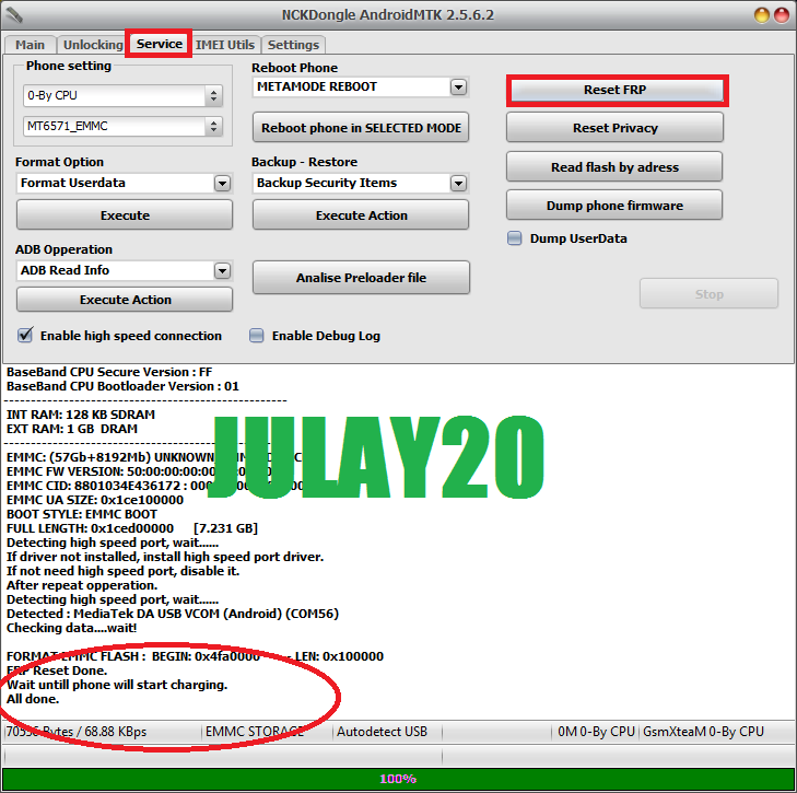

go to service
select reset frp
saksak usb wala ng boot key kc mtk naman matik na yan
hintayin mag done

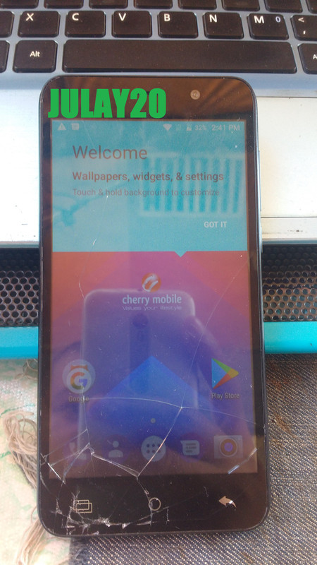

hintayin mag done
