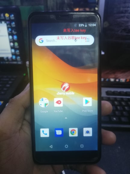

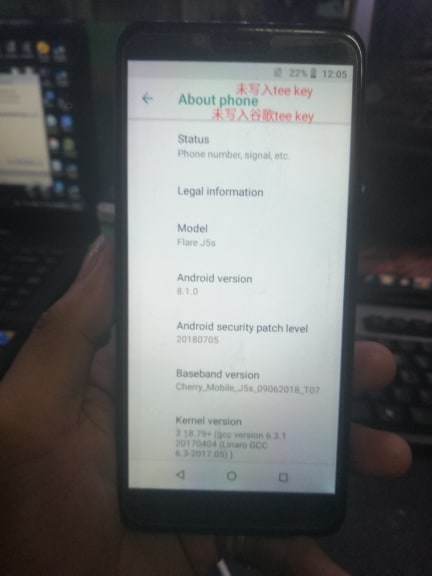

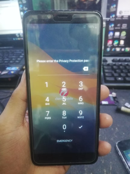

share ko lang mga master :]
fomart using cm2, nck crack, miracle , negative :]
kaya hanap solution :]
eto tested firmware ;https://www.4shared.com/rar/UTBOZylWgm/MT6580_EMMC_Cherry_Mobile_Flar.html
creadits po sa may ari ng fw !
note; back up first ..

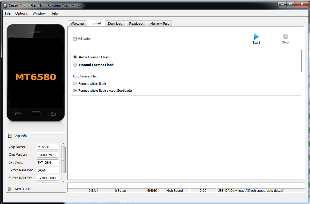

dL Flashtools ;https://spflashtools.com/windows/sp-flash-tool-v5-1620|
Open sp tools . go to Format sec/
format lang unit !
[dead na unit]

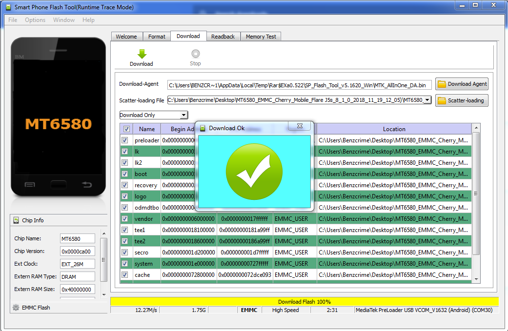

go to DOWNLOAD SEC /
LOAD SCATTER FILES ! DOWNLOAD ONLY !
AFTER FLASHING ! |
HARD RESET NYO NYO LANG Po
using VOL/UP- POWER BOTTON !
select recovery !
finish product !
Done na po..
