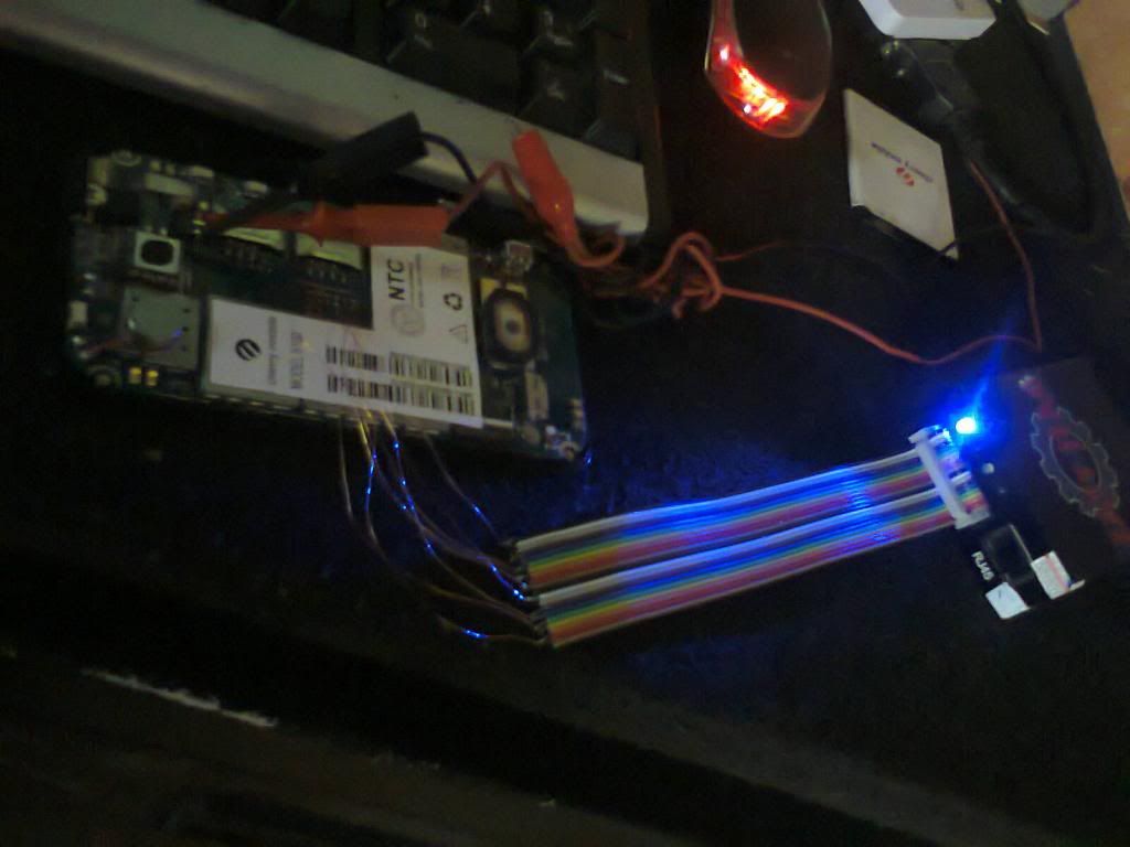

Procedure :
Open EasyJTAG Tool
Click JTAG Tool
Click Brand ( Model ) S100
Solder Pinout
Click Connect to Device
Navigate Dump file from folder ( file )
Write Target Flash
Wait Until ( eMMC Write OK! Elapsed time: 5720.588379s (91.649 KiB/s )

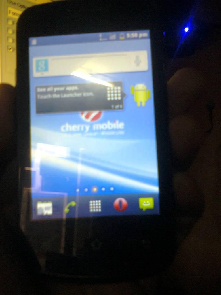

done na

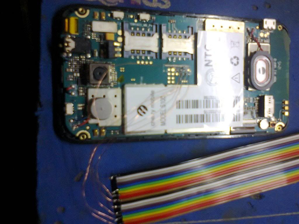

Procedure :
Open EasyJTAG Tool
Click JTAG Tool
Solder Pinout
Write Target Flash
